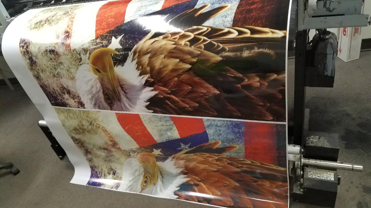

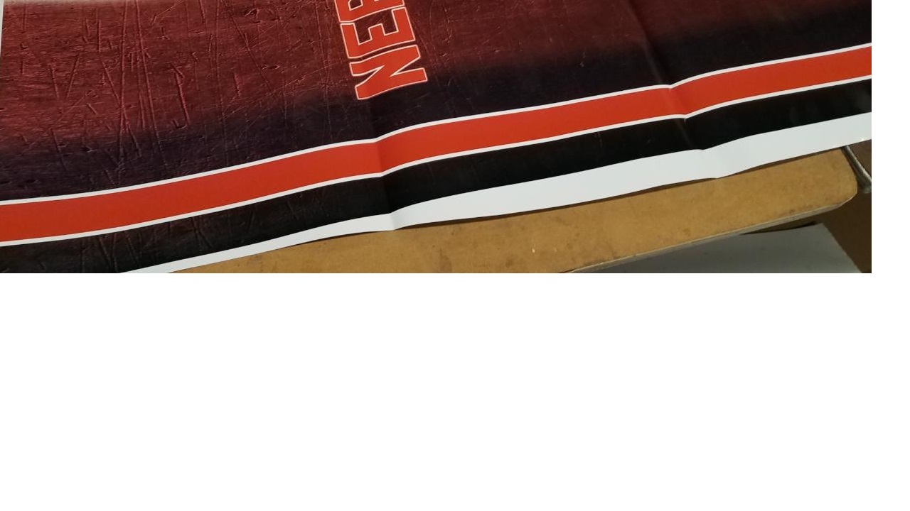

Still having issues. Sometimes it prints great sometimes it doesn't. I think it only happens with black and magenta, but not 100% sure on that. Someone else normally is operating the printer. It's not the maintenance station, I dont believe, it's been replaced. We've went through hundreds of feet of vinyl. Itll print great for hours, some days you come in and it wont print right for a long time.
You can see in the pictures, it's just a hard stop of one of the colors. Since the colors are on two separate dampers, I would think that would rule a damper issue out?
Any more suggestions or if a service tech is needed. I've never called one? Are they pricey?

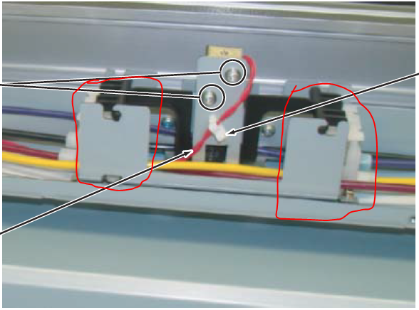

It could be what Mutoh calls the Solenoid Tube Assembly. They are used primarily for ink up only. I have seen several of them fail and cause the head to starve. If you have the right diameter tubing you can completely by-pass them and test the printer.
