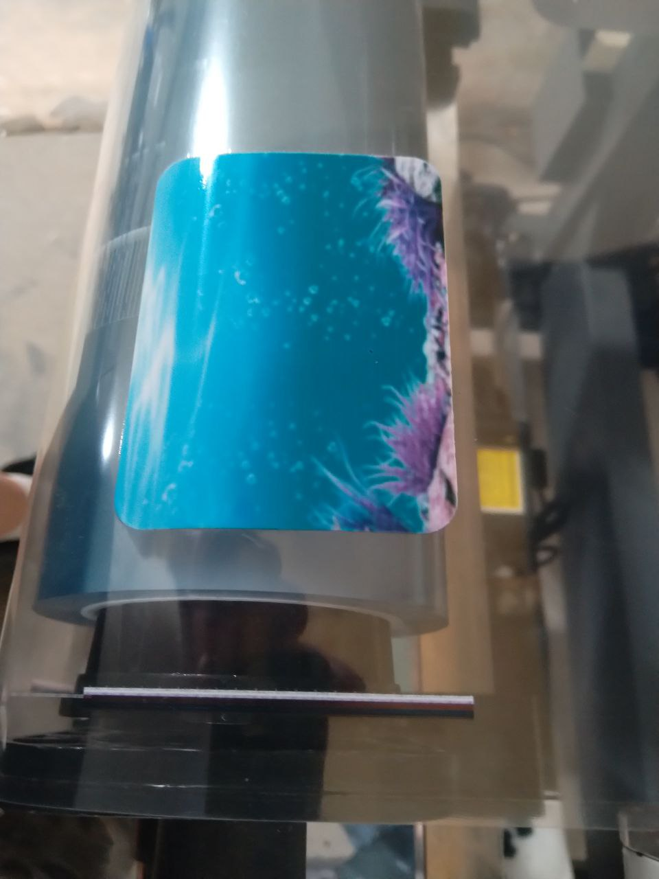

Need to do an air purge on the lines, but I have all 4 heads pretty much locked in. Gloss looks great, have the lamp kicked back to the far edge of the print so it doesn't cure the clear until the very end. Gives it a glass-smooth varnish.
Ink was a huge disappointment, STS sent me a hard ink. Might be the only choice I have, as the heads aren't heated or anything. Doesn't have nearly the flex of using LUS-150 on the JFX200.
