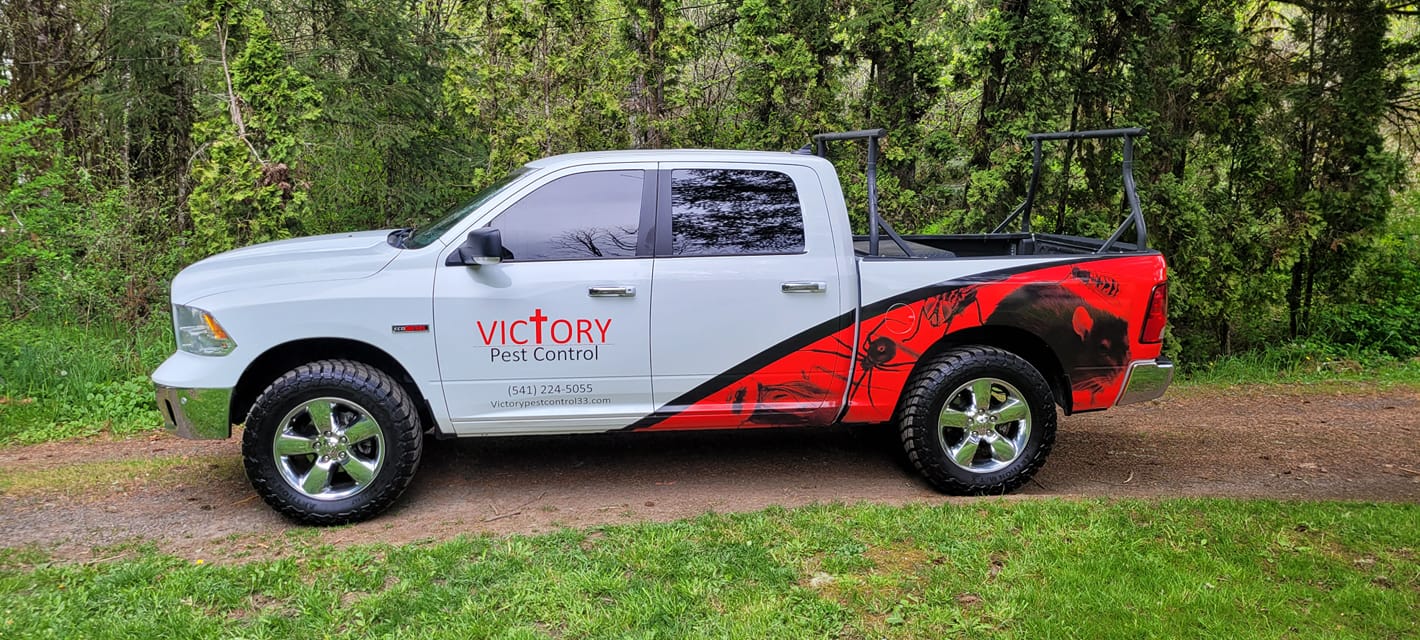

I have been doing design work for about 5yrs now on the computer, I ran across this project the other day. the guy calls me and gets a quote for the bed of his truck that he wants wrapped the exact same way as his other truck I told him I could do my best to get it as close as I can. now for the last 5 yrs I have been working on my google and youtube certificate for design. and this seems like it should be easy I just need a little more help pointed in the right direction of how to do this because at first glance I thought they were vector images. but the rat looks to be like its an actual picture just in a black and red format am I wrong? so now I believe all the pests are actual pictures just converted to a black and red format? so if somebody can help get me going in the right direction I use adobe illistrator for designing i would greatly appriciate it.

Yeah, the rat and bugs in the wrap design are specific images, not pieces of vector clip art. Obviously it would be a serious challenge to track down the exact same images used in the existing wrap designs. There are different methods how to convert color images to look black and white while still preserving a rich black color (as opposed to just converting the images to 8-bit grayscale that won't have blacks as deep). In Illustrator you can apply transparency blending modes to the image (such as multiply) to make the white in the image turn into the red background color. The same work can be done in Photoshop; just bring the finished composite image into Illustrator and clip it inside the red shape spanning the pickup bed.
victor bogdanov
i would in PS make the animal images grayscale, adjust curves to get the desired 2 color effect, then select (select-color range) and delete white. Paste the images on the red background in illustrator, done

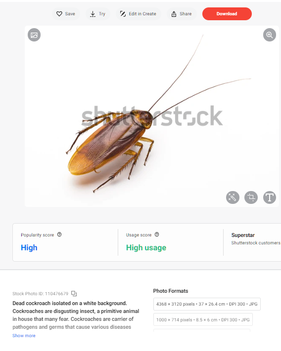

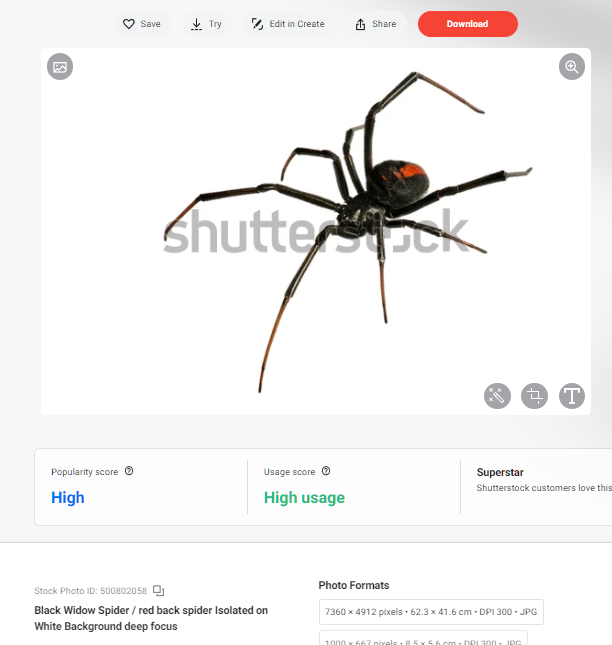

If you go on Shutterstock, search "spider isolated", etc. this will pull up the below. As for making them black and white, someone else can explain that, it looks like they also added a transparency. In my experience, most people are perfectly fine with "getting close" which I think the below are. It looks like that mouse might be eating, you could search "mouse eating isolated".
