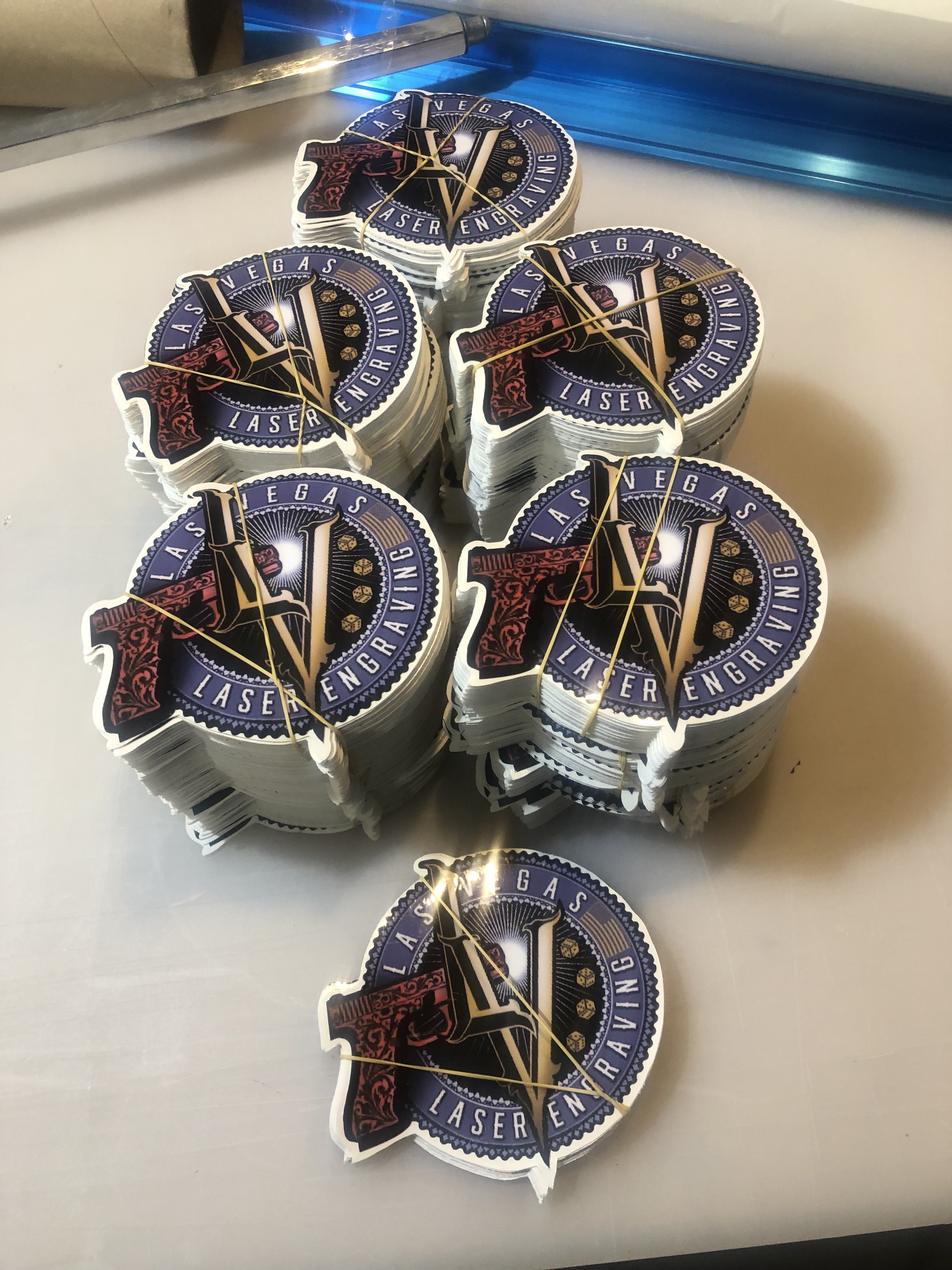

I setup a kiss cut that cuts exact... Then cuts a square around the media, but below the registration mark. I tell it to pause Inbetween kiss and perf cut... Once kiss is done, I'll weed it while it's still attached to the graphtec. Then I'll unpause for the perf. It - that way the paper gets a nicer cut, and you're not weeding little borders for hours. It's still not perfect, but it works.
