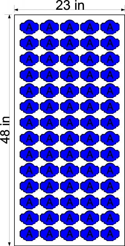

Ideally this is what I have in my head. Let me know how far off I am.
Lets take a 48" material. I design 6 completely separate jobs to be printed utilizing 48" material. After printing is done I will cut on the cut lines (that were also printed to make things easier on myself) giving myself 6 separate jobs that will all fit in my 24" Graphtec. Using the ARMS I now have 6 separate jobs all with a crop mark (or crop marks if I need more). Notice the blue circles were printed with a different orientation to get the best material use.

Yes, you will be using Illustrator, not Master Plus. Your version will not support the contour cut process.
In order to use the Graphtec RMS firmware, you'll need to print Graphtec registration marks, not "blue circle" style crop marks.

an easier way is to lay your decals out in 23" x 48" panels with a black box around the outside. the black box will give you something to line your cutter up to.
this way your not cutting down the middle of the print, but just cutting off every 24" of the print, depending on how many decals you need.
laminate the print, feed it into the cutter. choose the outside of the black outline box. line the cutter up to the bottom right hand corner of the black box, define the origin point, make sure you have any offsets to zero and turn off the advance after plot. cut the box, if it lines up ok then go back and select the die cut vectors along with the black box. send it to cut and your done.
