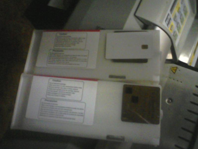

Only seen 1 post on here for it, but I know the cart I have is a 220ml for a falcon jr! Anyone know if theres anything I can do to get it going? UGH! Get my ICC's figured out and go to print a job and now this! Frustrating!
randya
Check the orientation of the foil label.
Compare it to carts that work.
If I recall correctly, that label is rotated to indicate ink type.
Knep
Once again you nailed it! I took the chip off the side and had to move the chrome sticker forward, and it worked, I knew it had to be something like that because the part number was the same!

On those carts the rotation of the label tells sensors in the cart holder if it is pigment or cleaner (on indoor machines it is pigment/dye or cleaner).
