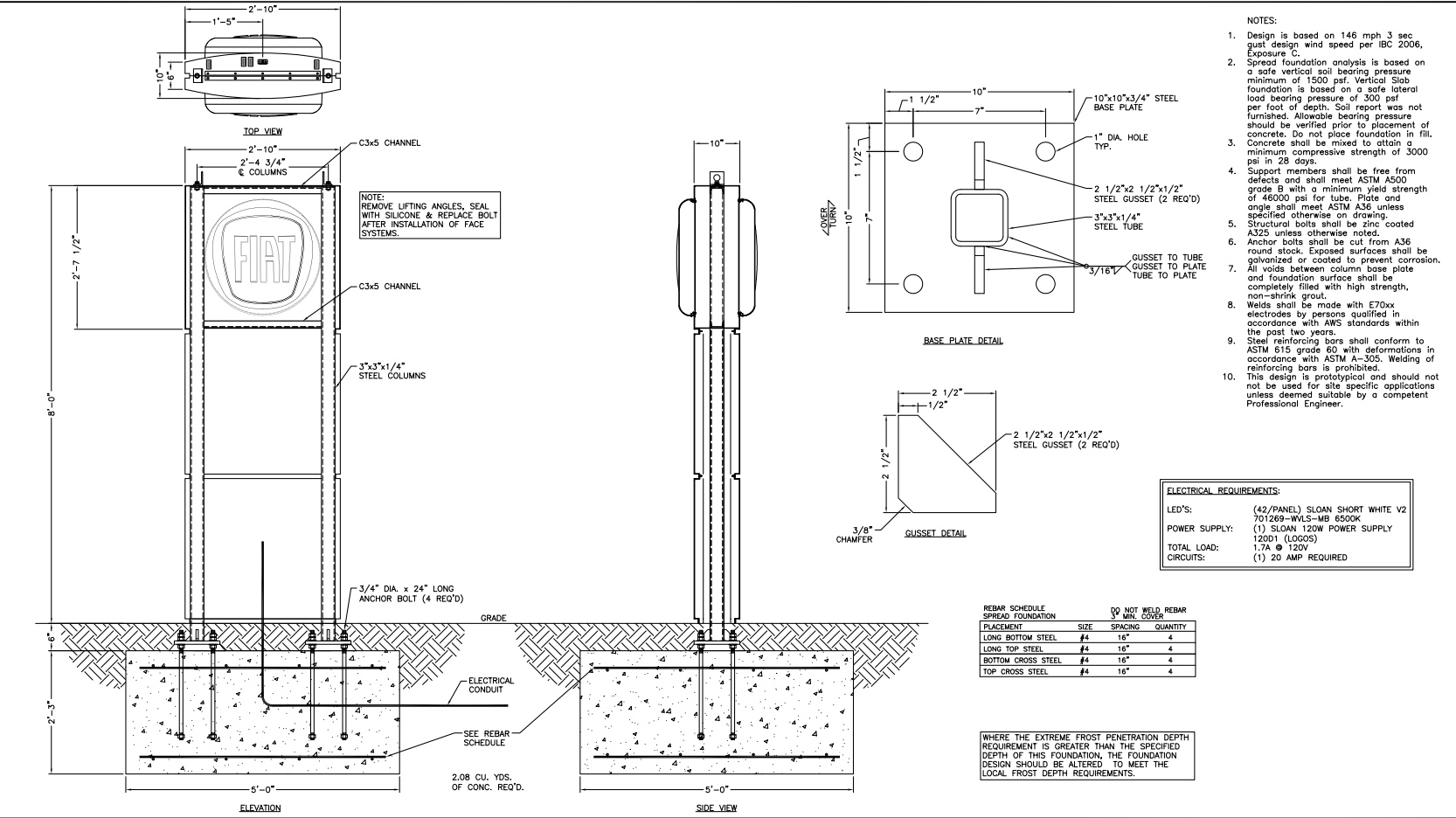

Hi Everyone,
I have a quick question. A 3rd party sign company has asked us to remove a small 8' ground cabinet at a local car dealership. My crew isn't trained to use torches, so we have the choice between cutting this down with a reciprocating saw and/or grinders or digging up 6" of asphalt and trying to release the hardware. If we cut, what is the best way to cap the columns?
I'd like the experience, but also want to do it safely and efficiently. Looking for suggestions. The client is looking for us to do this in half a day.
