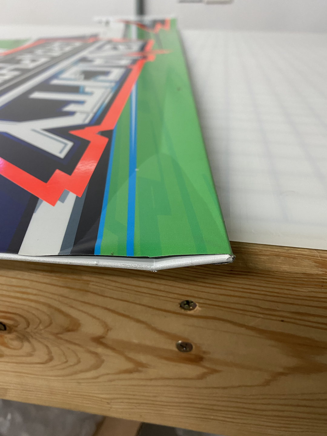

Just looking for something that will have a better adhesion, seems like I can lay a car and in the smallest spots it will lift overnight. The picture is a bit of an over kill on the material lifting as its been hanging on the shop wall for a few years but just trying to show the the angle that I'm trying to wrap that lifts when using the Arlon DPF 4500MLX material.

It looks like the edge started lifting and then tracked down the channel
Avoid a full bleed when using a calendared vinyl, or edge wrap if full blood.

I don't think it was the edge. Looks like the low area was bridged and then just pushed down like already said. Walk it in or if you're gonna push it down, heat it farther back before you squeegee it down so it pulls material and puts tension more on a flat area rather than dead center of the low spots.

It's calendared material. You can't install it like cast wrap material. Even in a shallow angle like that you have to lay the material to the angle, then continue on to the edge. It will always lift back up if you bridge the gap and press it in, stretching the vinyl to make it stick. Typically before the next morning it will always pop back out again.
