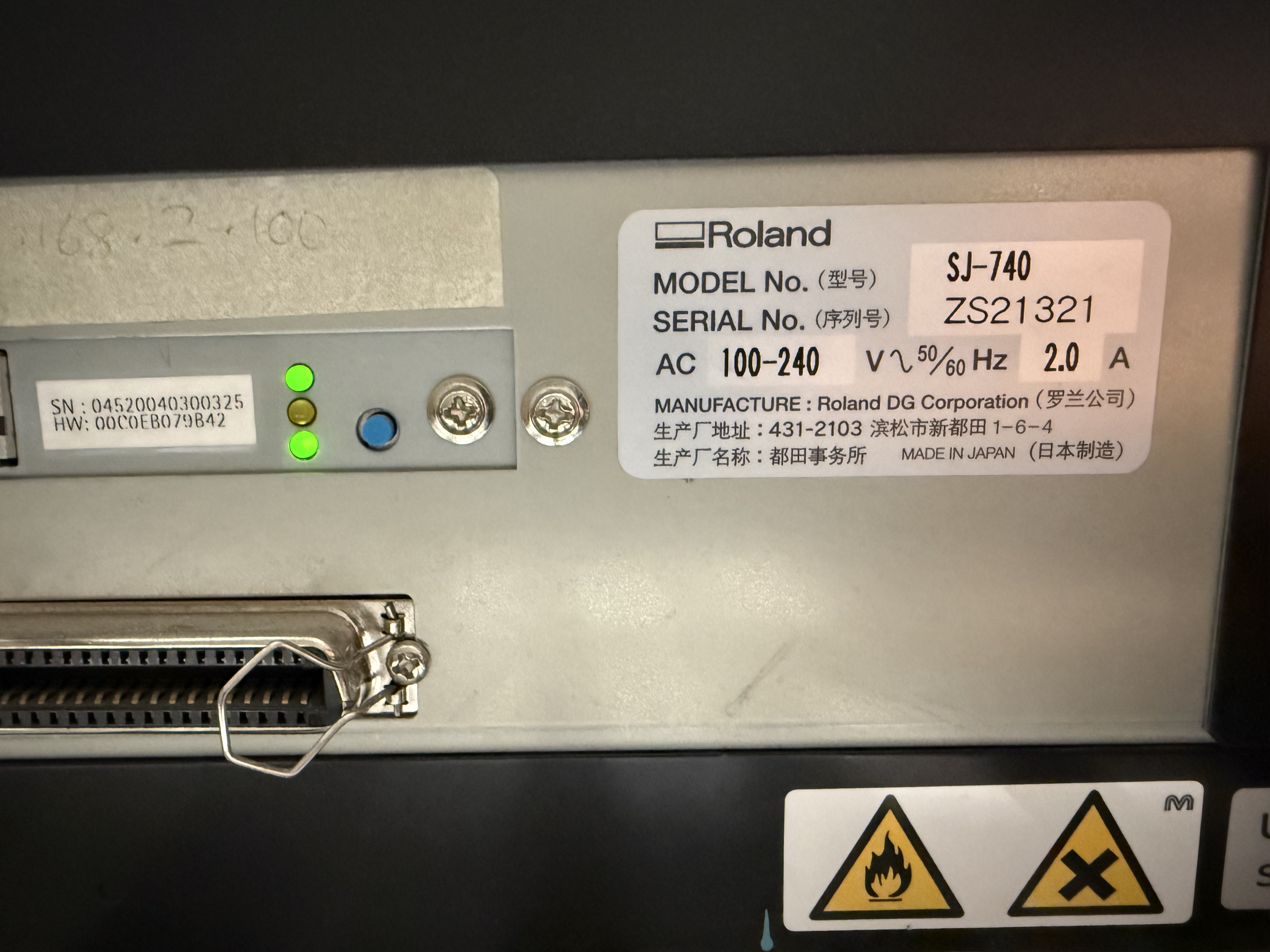

Question Does anybody know how to convert a Roland SJ-740 to a SJ-740EX ?

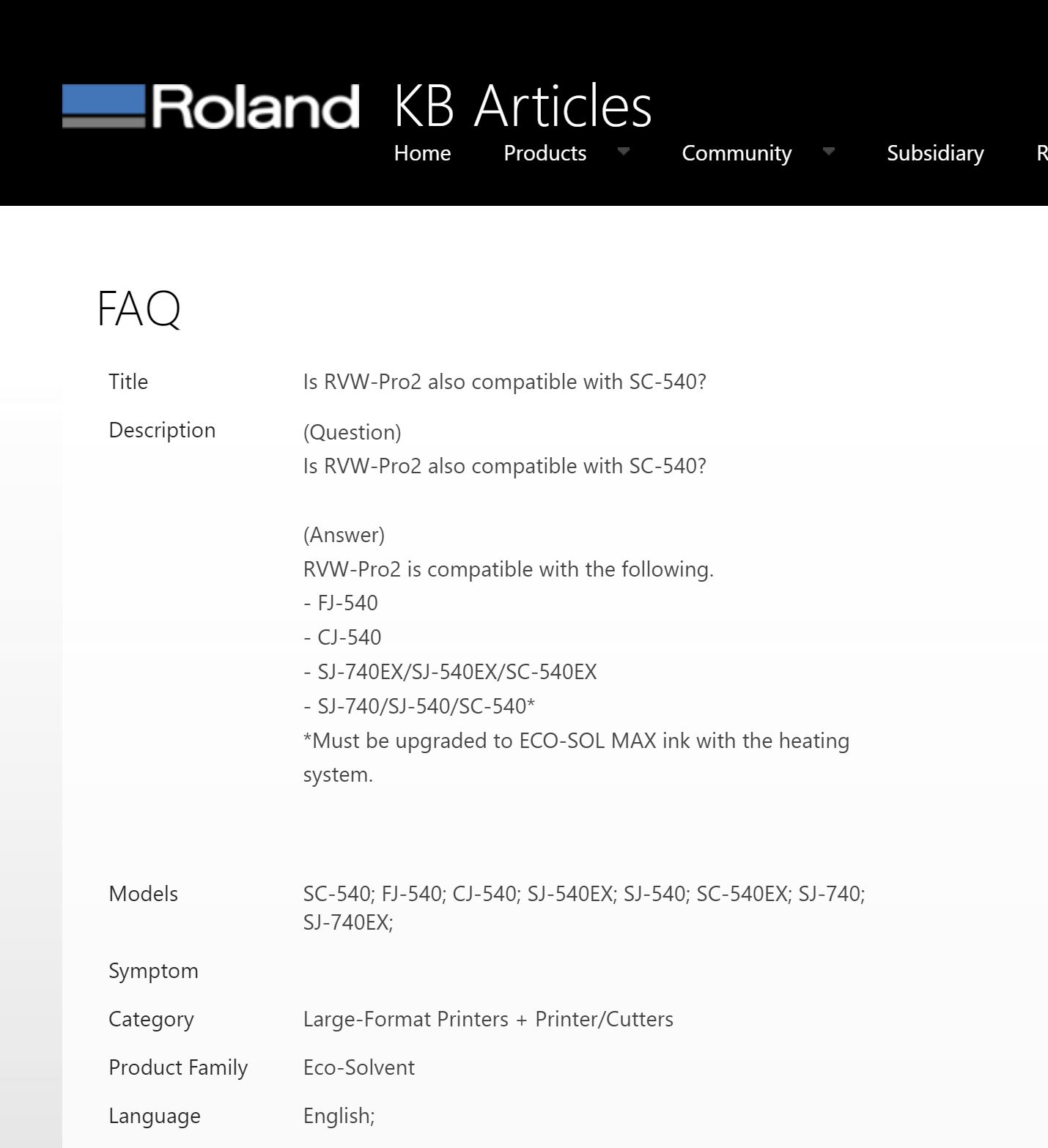

I've attached a PDF of Roland's mainboard compatibility and DIP switch settings. According to this, the SJ-740 and SJ-740EX use different mainboards and aren't compatible. That being said, perhaps trying the dip setting might be worth a try. This thread may also be helpful - https://www.signs101.com/threads/roland-soljet-pro-ii-sc-540-for-sale-200.143574/. In addition, I found something about the SJ-740 can be run with RVW-Pro2, which I believe is a pay for version of VersaWorks that comes with a dongle. I've heard of this version of VersaWorks, but I cannot find any other info on it, except a screenshot of the Roland page.
