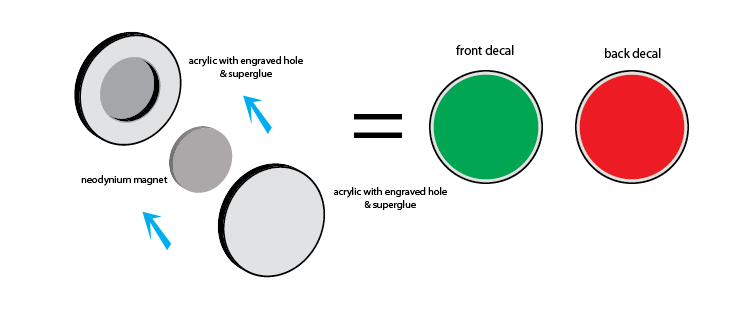

How would I make it?
I'd make acrylic buttons/dials that you can embed/encapsulate a couple of neodynium magnets into (pic shown)

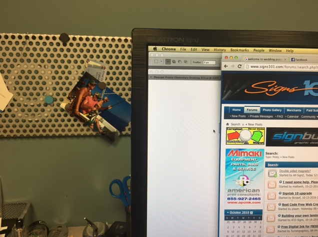

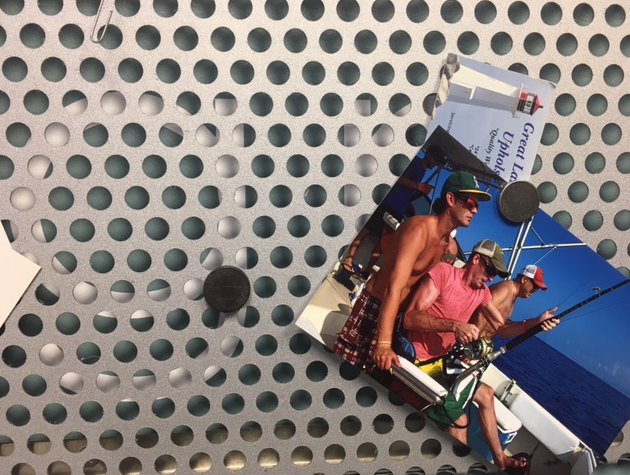

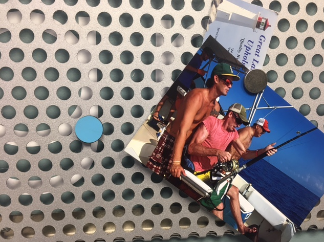

also noted, that, if you only need 1", or so, sized magnets then you can just pickup a bunch of ceramic magnets from Master Magnetics at your local Home Depot.
they're strong enough to hold up with vinyl applied to either-side. Neodynium is nice, but more expensive.
pics of a perforated steel panel behind my computer screen with .25"thick .75"dia ceramic magnets with 3M vinyl applied.... and me reelin' in a 600lb Marlin :toasting:
