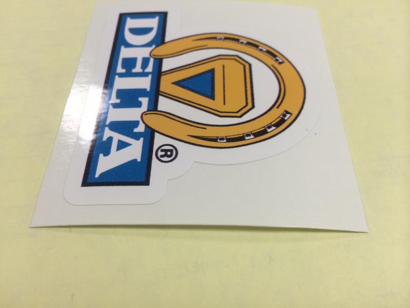

I get that if the client wanted the labels cut to the shape of the contour but these need to be contour cut then cut out into squares as well.
I may or may not weed them like in the pic.
