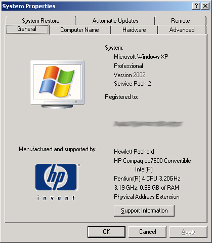

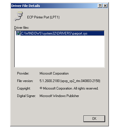

theskipman_98
I don't know if this helps, but here is our set up with our computer here in the production room. we are running HP's here.
Maybe it will help. Our Edge connects to a what looks like a standard printer parallel port. We have another PCI card that looks like parallel port, but it feeds the DeskJet printer.
Just used the Edge a few minutes ago, and these are the settings on ours.

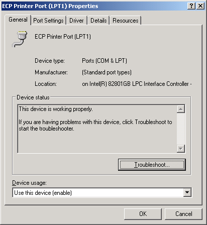

signage
cptcorn did you check you bios setting to make sure the card is set-up in it as ECP then also check your device manager and make sure it says ECP.
