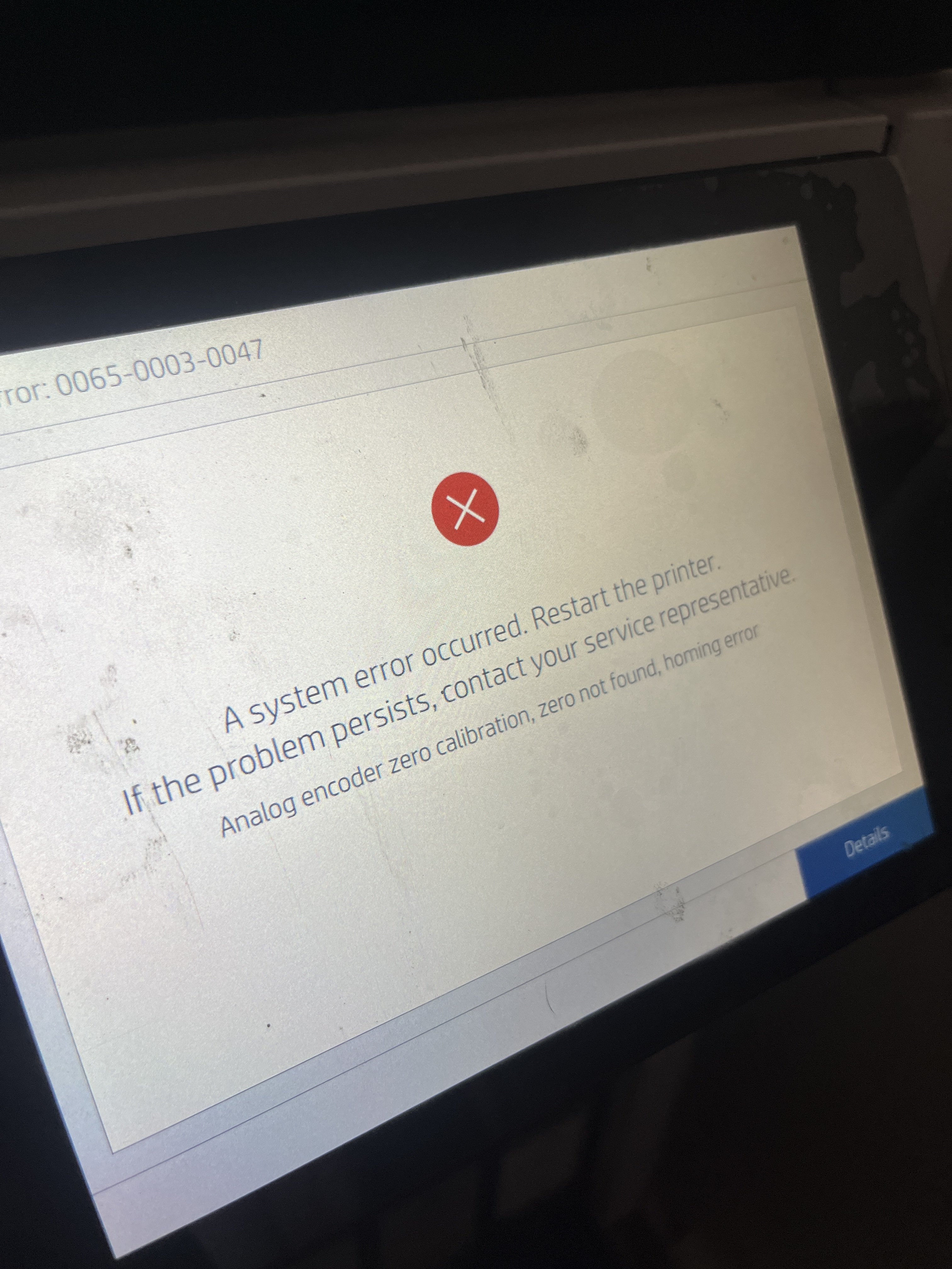

Have been working a bit with HP, who is saying if it’s not firmware (which it isn’t), then he KNOWS what the issue is.
I’m hoping prior to having HP come out to replace whoever they’re wanting to replace i could ask around if anyone’s had this similar issue. My 700w has been great since they got it working (it took a few months) but this issue has stumped me.
I’ve cleaned the crap out of the encoder strip. There’s the tiniest of scratches on the clear part in one small place but besides that it looks to be in great shape. I haven’t found much info on cleaning the encoder sensor or if that’s even possible on this machine.
Aside from that, any thoughts? I’d appreciate any and all input.
