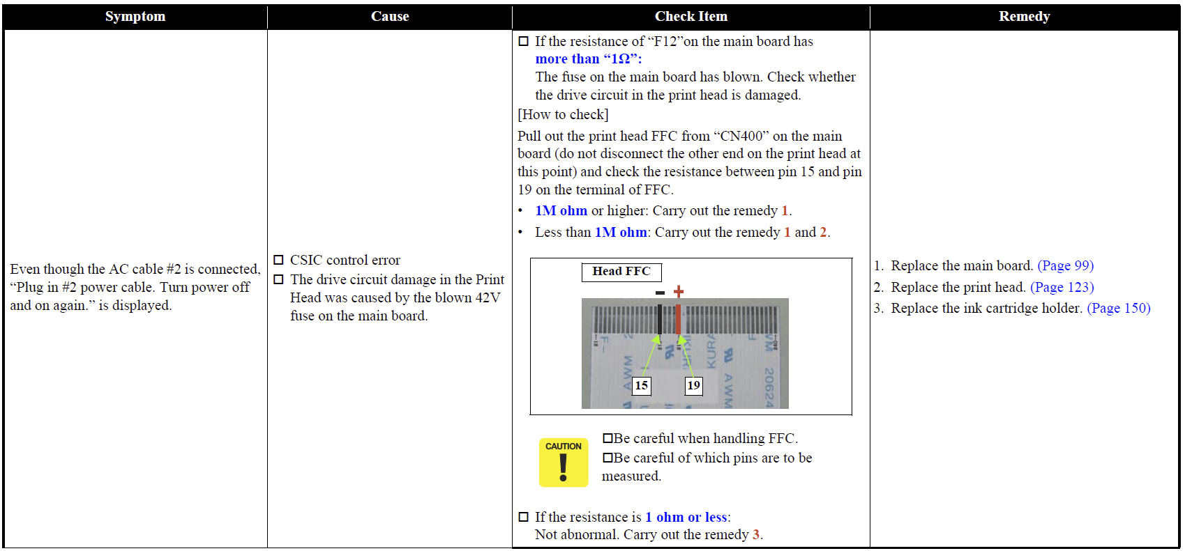

The main board has imbedded fuses (forget the technical name) that can't be replaced without soldering. It seems to happen a lot - the tech who did my printer didnthe same thing... Machine was powered off, but he blew a fuse on the board and had to replace it.

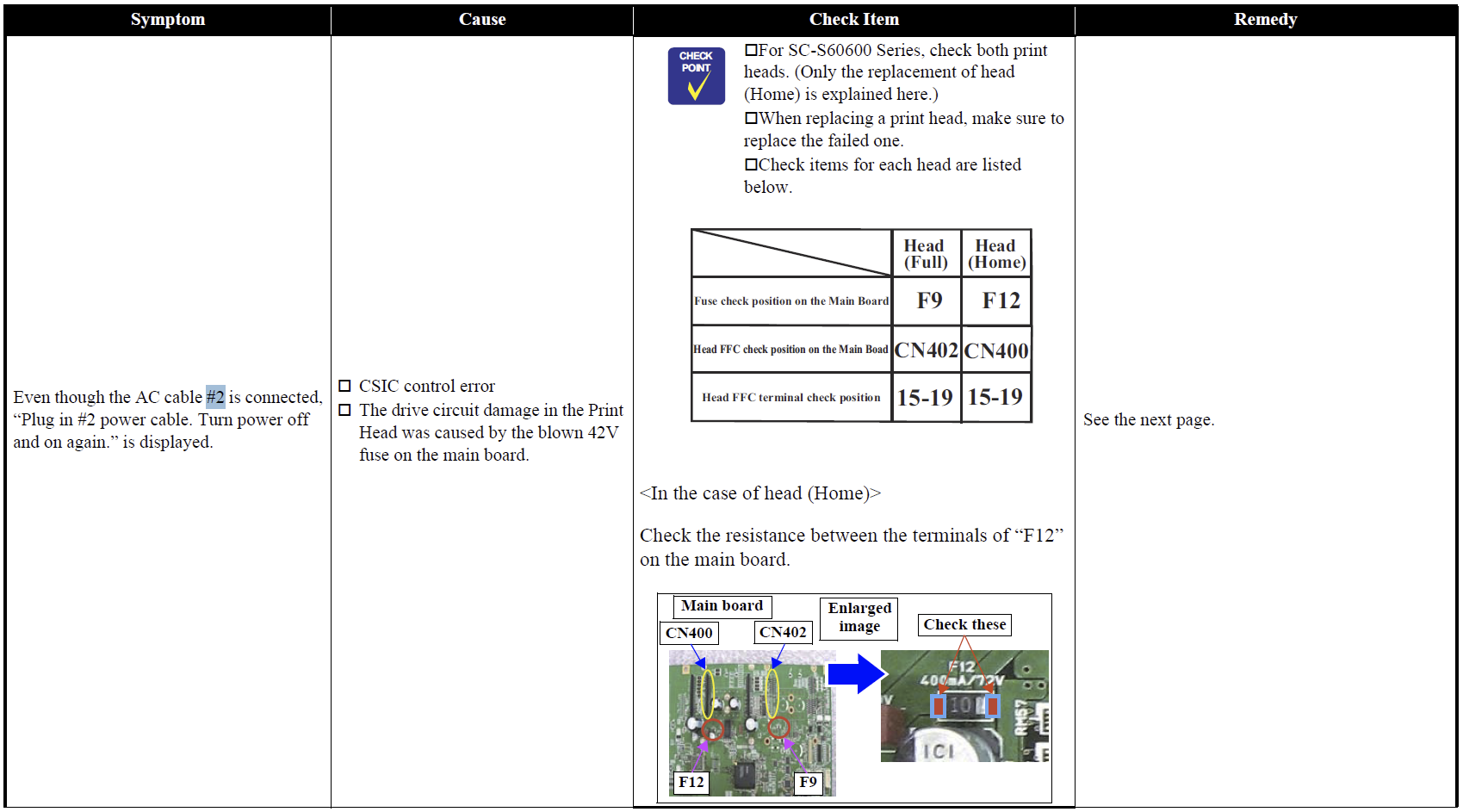

The manual should have diagrams as well as voltages each pin on the main board is supposed to hit, you can check with a meter and see if it's a blown fuse or not... But likely it is.
ikarasu
If you scroll up, signmeup posted it - you're measuring the resistance between a few pins / spots.
Odds are its a fried mainboard - Good to test if you dont want to order one, but since you already did you're probably best to wait.

The solution to this is to replace both power boards AT THE SAME TIME.
It took Epson 11 weeks to puzzle out our printer.
The repair is clearly stated in the manual — and it's clear that both boards must be replaced at the same time.
