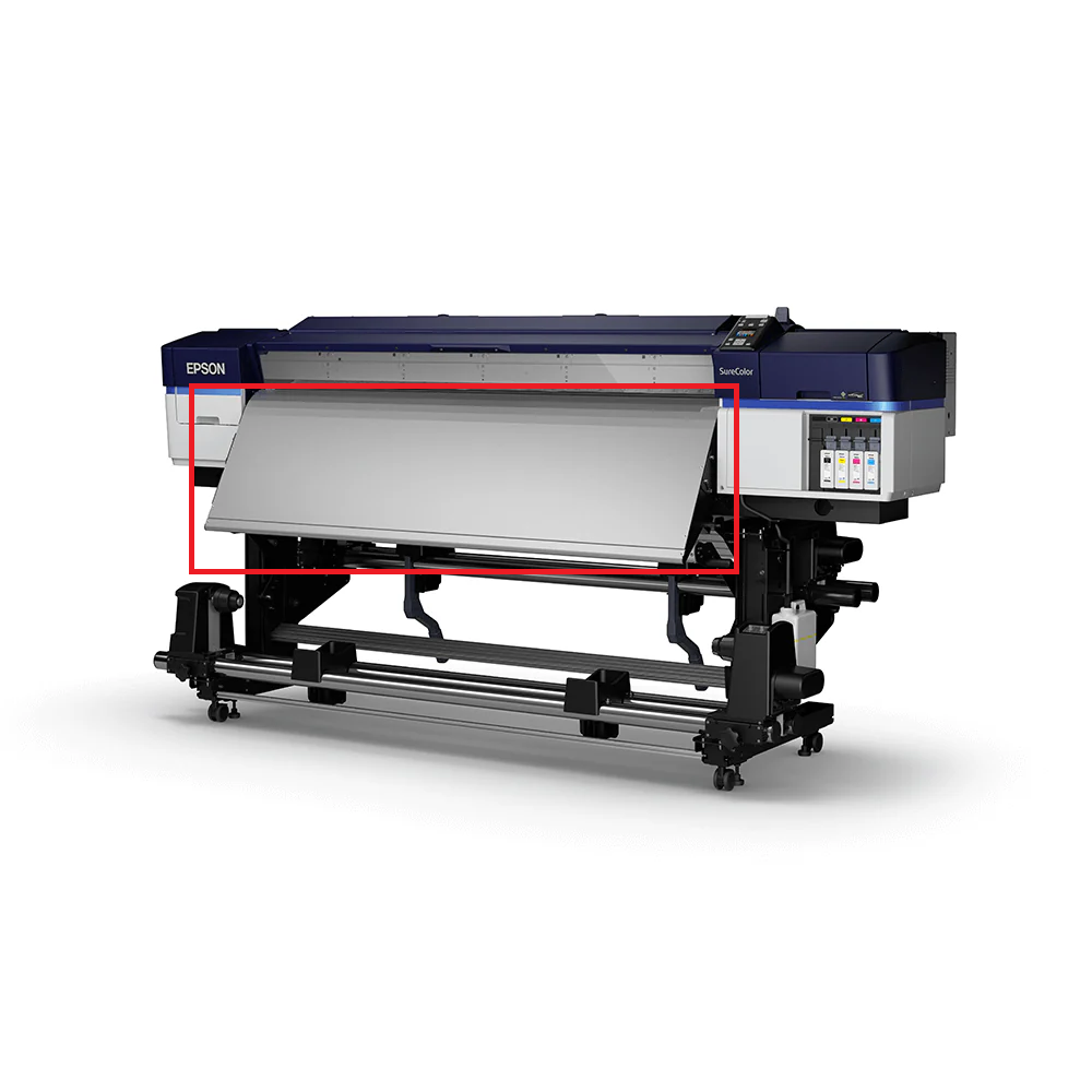

Thank you for your answers, they are helping me with my decision. One last question: I only have an 80 cm door, but according to Epson's specifications, the printer is 1 meter wide. Now I'm wondering if the part marked in the picture can be slid in, otherwise, I probably won't be able to get it through my door.

That part that you are referring to is the heater.....I am am Epson tech and have removed that part to get it through doors. There are a several screws around the perimeter that hold that cover on, the cover also has the heating elements strung under it. Once the screws are removed, lift up and towrds the top of the printer, the top has an overhang that it rests on. Once that it off there are three to five cables to disconnect....take a picture and label them. Then I believe there are 4-6 allen key bolts holdin that hanger on....should lift right off. I can get better instructions if you need them.

My two cents as an Epson tech as well. Wefixprinters is right on, I would just add you probably want two people to remove the heater, one to hold it while the other unplugs the cables. When I first removed one, I was confused by the connectors and they are a bit hard to see, but they all have easy disconnects, so if they aren't coming off easily you're just not squeezing the correct part. As for the waste ink, we always recommend Kitty Litter. You can get a bucket, put it near your printer, and dump your waste ink into that. It'll last quite a while, and once its full, you can just throw it in the trash. Works great! As for the lifting you really need at least 4, and a fifth person is nice to be able to help you line it up on the stand. But they are great printers, great quality and very low maintenance.

Today the printer arrived. The pallet was huge: 100 cm wide, almost 3 meters long, and about 1 meter high. The printer itself, including the heater, is about 78 cm. With a lot of effort and sweat and using two small trolleys, we managed to get it through the 82 cm door without dismantling the heater. In case anyone needs the dimensions for the printer: it’s of excellent quality. I’ve already printed with it and am satisfied so far. There are many small extras that the Mimaki doesn’t have and many automatic settings. The only thing that bothers me is having to cut manually, haha.
