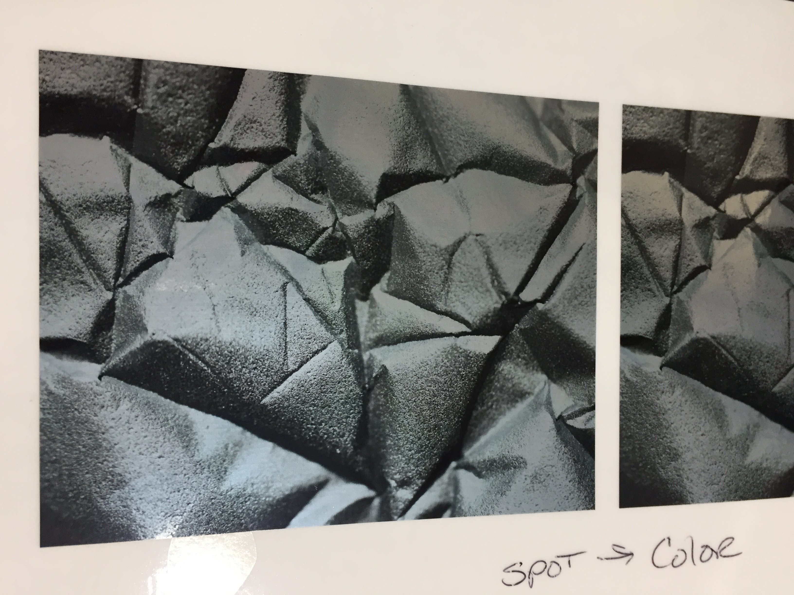

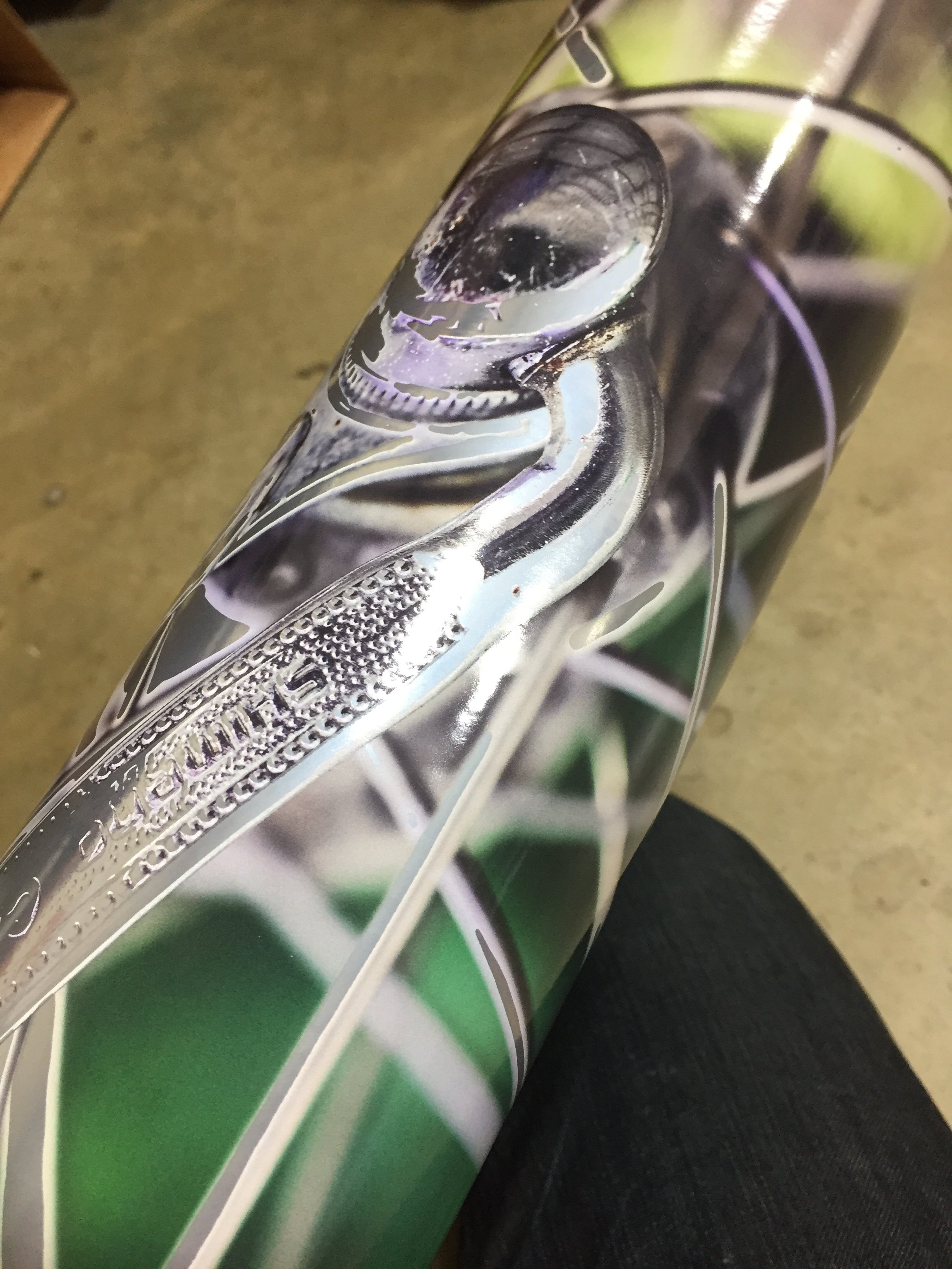

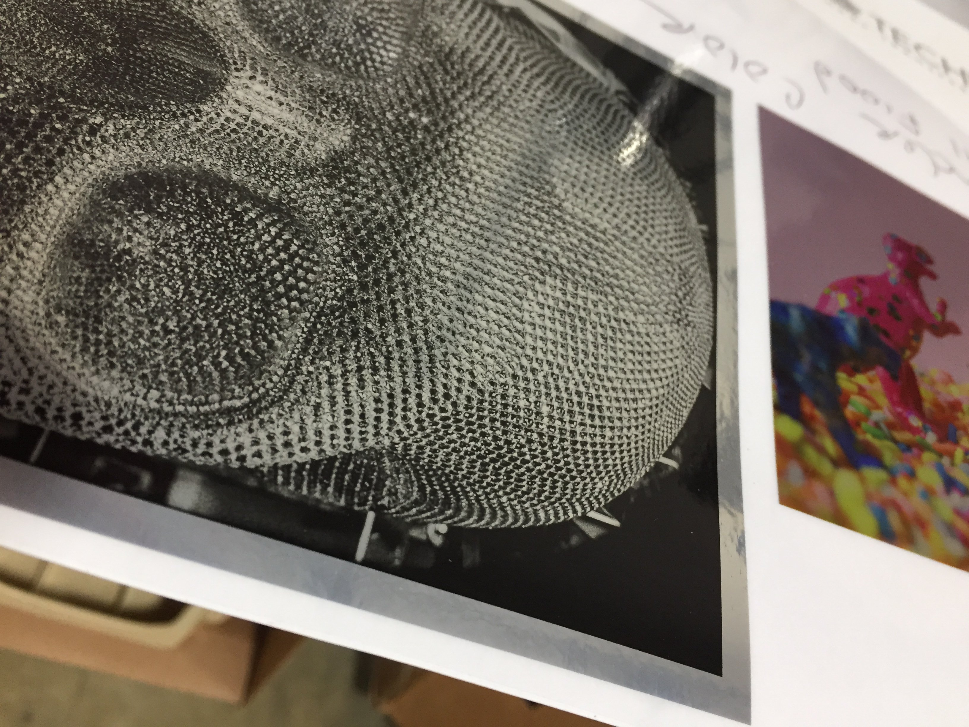

We've got the S80600 and i recently ran a bunch of metallic silver samples but we use ONYX. Here are some photos... IMG_0080.JPG IMG_0081.JPG IMG_0082.JPG

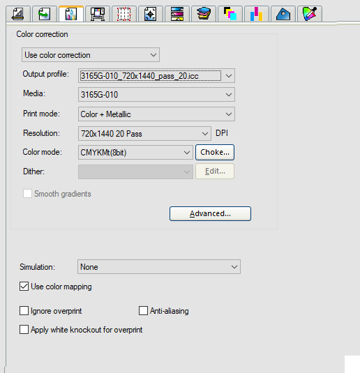

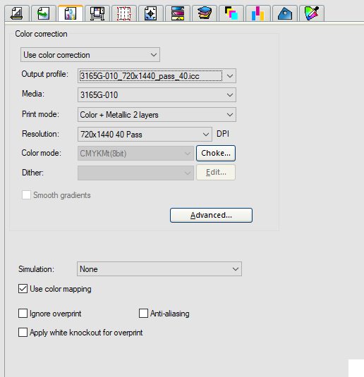

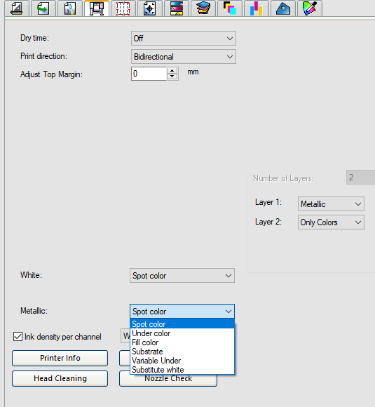

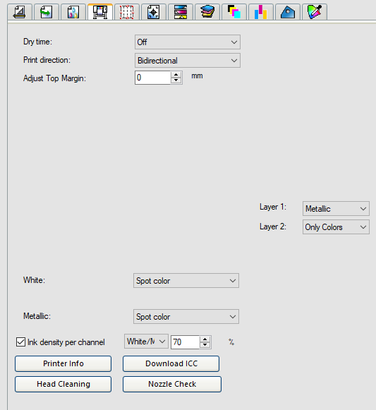

Hello, it is possible. Just select a 20 or 40 pass profile. 20 pass printing is for simultaneously printing color+metallic with both heads, aka 1 layer. This works fine for color and metallic side by side. 40 pass is when you first want to print a metallic layer with one head, and color on top with the other head. This is Layer 1 = metallic, Layer 2 = only colors. Nice for metallic color effects. Because of a bug in Production Manager 19 build 3260, you have to enter a metallic ink limit, otherwise it will print 0% metallic ink. You can look at the ink limit for cyan for instance, and use this or a little less for the metallic ink value. Save this setup as a preset, because every time you select another profile, the metallic ink value is set to zero again.

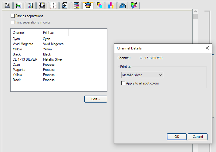

If there is no metallic spot color in your file, you can generate where metallic should be printed: under the whole image, only under valid pixels etc. If you have used a spot color, then map that color to the metallic ink channel.
I have reported this metallic ink level bug to SAi yesterday, so regularly check if there's an update that fixes this.
04 metallic ink limit - layers - spot or generate content.png 05 select spot.png 03 metallic ink limit - layers.png 01 1 layer.png 02 2 layers.png
