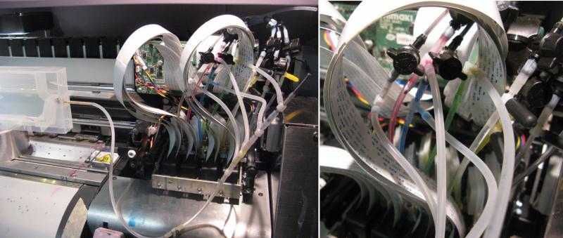

custody wash for mimaki... you can fill the caps with solvent and that will keep the heads wet. but for an extended amount of time, the lines to the pumps will gum up. so if the machine is off for a good bit, get the ink out of the printer. i don't custody wash. i run a manifold directly to the heads just above the dampers. and then pull ink through the system under the pumps.
right now the printer is idle because of programming cnc tool paths, and photoshopping pieces for the next weeks projects, so it's put in a quasi-custody wash. takes about 10 minutes. wastes much less ink than even running the routine cycles would for the week.
