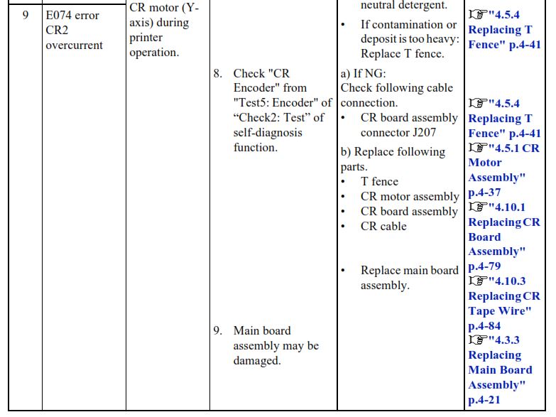

error code
hapycmpr
Manual
MikePro
looks like you're jammin' up. clean your machine, and most importantly, lube your rails.
...otherwise your y-motor will burn up.
Richard G
I use 3 in one oil on a rag and wipe, not a lot. I won't use WD either not really made for this type of application.
