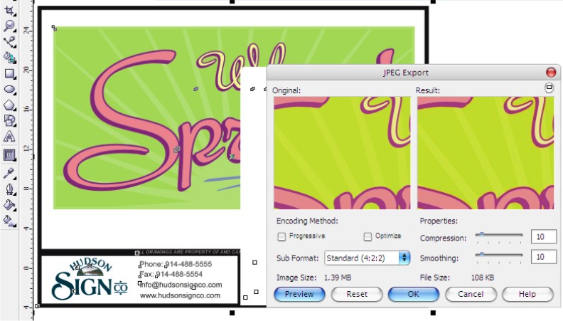

This just started recently. See the difference in the actual drawing and the export preview? What gives. All designed with pantone colors. I used to get a dead match on exported jpgs....what the hell got changed?

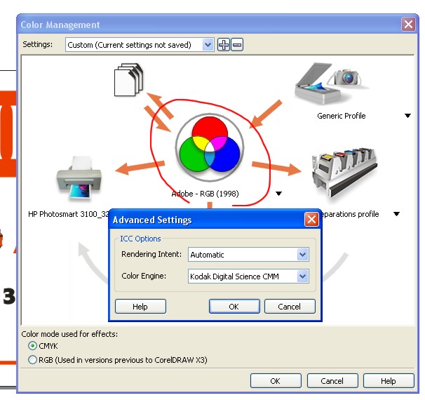

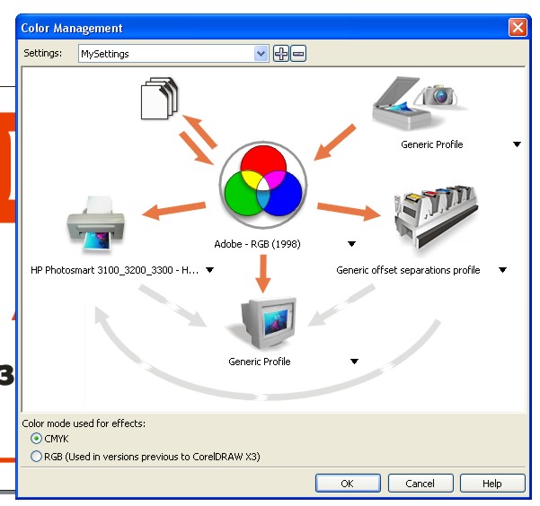

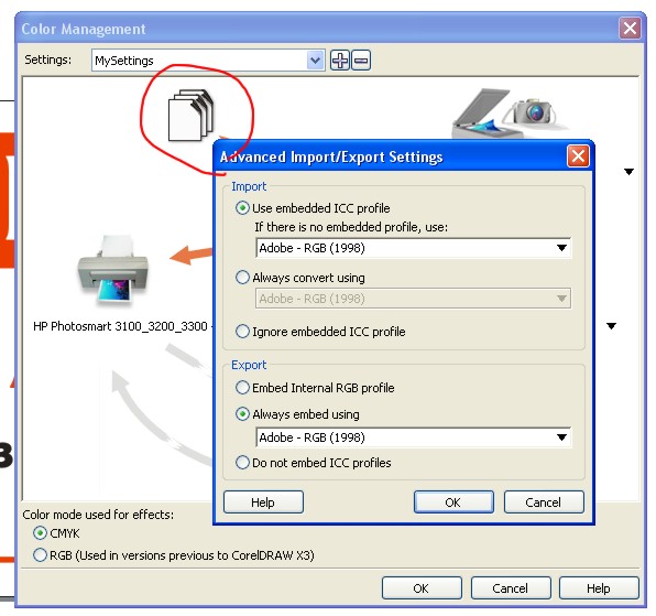

Not sure if this will help, but here are my settings which seem to be working.
