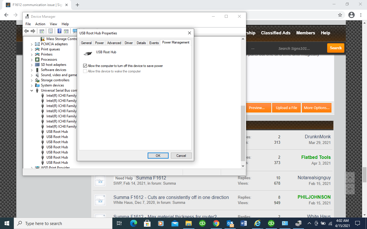

Canucksigns,
if you don't mind, give this a try.
go to device manager > usb root hubs > power management
clear the check mark for "allow the computer to turn off the device to save power"
microsoft has caused all sorts of problems with our networking with this setting & it has no business even existing in the usb connectivity. go down the list of root hubs & clear all the check boxes.
the geniuses at microsoft don't seem to know how to write code to recognize when a device is in use AND SHOULD NOT BE TURNED OFF

I checked and these were already set to not power down
