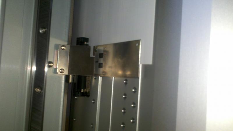

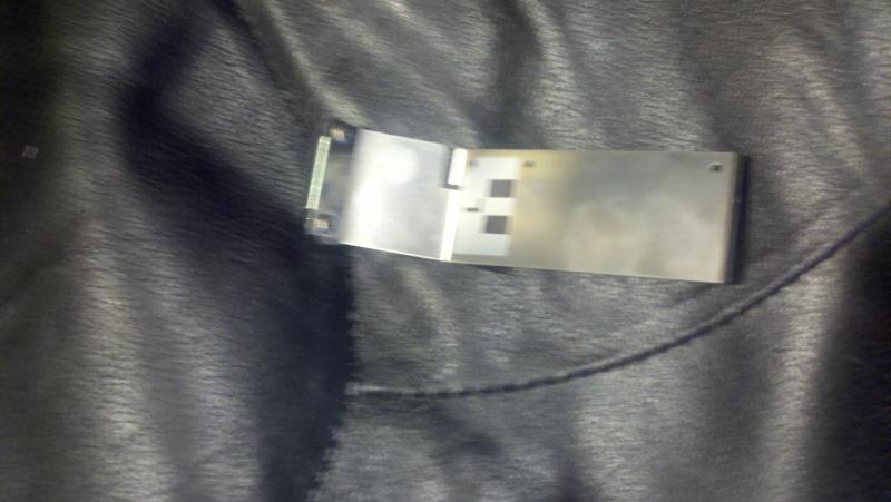

My Roland came with 2 of these nifty little gadgets that I would think might work for the problem you are having. All they are is a piece of metal with a magnet attached to them. Maybe you could make something like this.

I dont think these ever came with guards, but bayshorecreations is on the money. I think these maget types came out about the Toucan LT timeframe for Mutoh. You should be able to make your own pretty easily, but you still will want to be careful with them.
