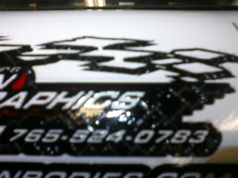

Whats the best ICC settings to use for a Falcon Jr? I got my heads lined up right, but I did a print of my own logo, and it looks like its laying twice as much black ink as it should...I am using an ICC i downloaded off 3m's site for the IJ180 somthing or another vinyl lol...I forget the number on it right off hand...

You actually dont want an ICC, I think that is a CFT maybe a PTF (though I think this was 7.6 or even 8.1).
This will have all the proper info, ink limits, linearizations, and ICC.
SAI ICC's are for 8.5 and above.
