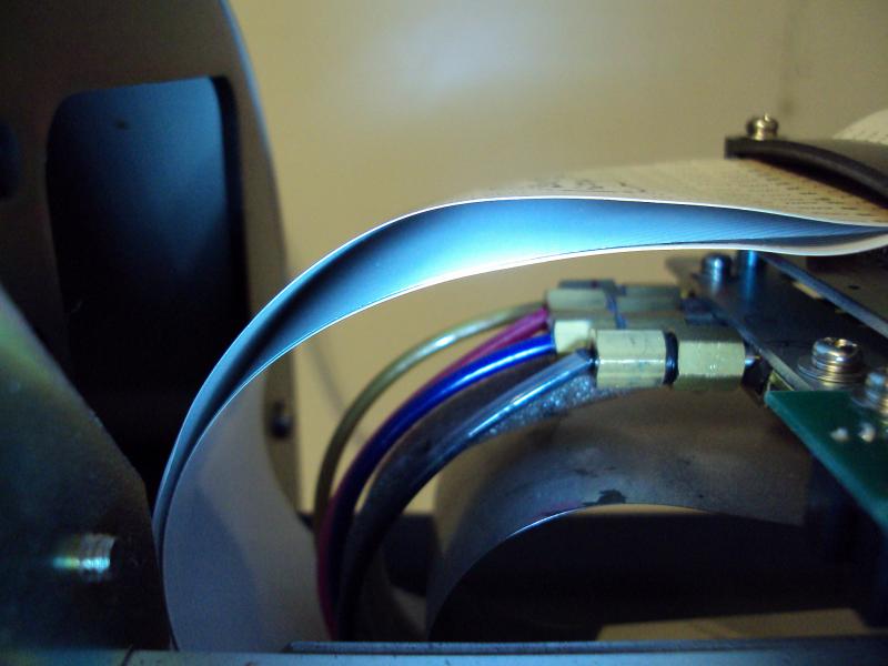

thmooch
UPDATE:
Take a look at the pic...broken or pulled out Black & Magenta lines when carriage goes all the way to the left. Causing loss of vacuum/ink. Can I trim these or where is the best place to get replacements? Should I get new O-Rings while I am in there. Would you replace all 4?

artbot
you can also get a tiny brass tube and make a small union to add just a little line to fix. after cutting the brass tubing clean it up really well.
thmooch
so I trim about 1/4" off the tubes, filled dampers, pulled waste line, ran a cleaning...wait for it...got my 2 - 3'x4' prints.
I want to go ahead and replace the lines. Does anyone know what size tubing or where to get it?
