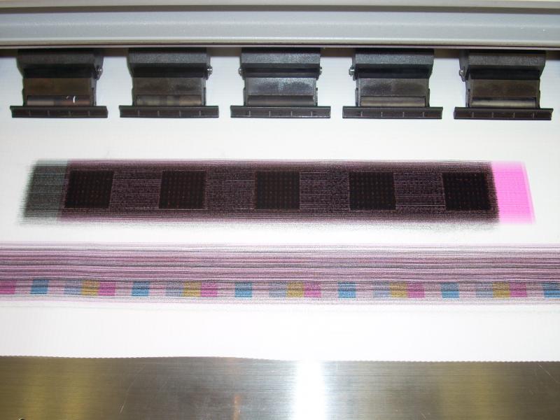

OK here's the story.
Turned the printer off.
I pulled the KCM head. (No Problem)
I cleaned it with cleaning solvent in an ultrasonic cleaner. (The K was clogged pretty good) When complete all 3 (KCM) had a nice "rainfall" of cleaning solution easily pushed through them with a syringe.
Reinstalled the newly cleaned print head (No Problem)
Turned the machine back on.
Ran a cleaning cycle and nozzle check print, then a print of 4 orange triangles.

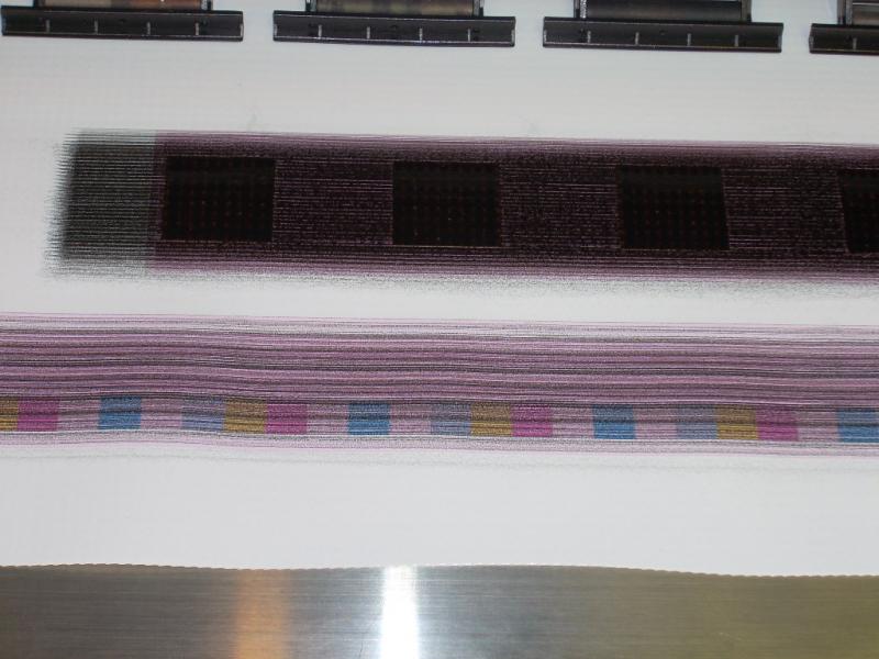

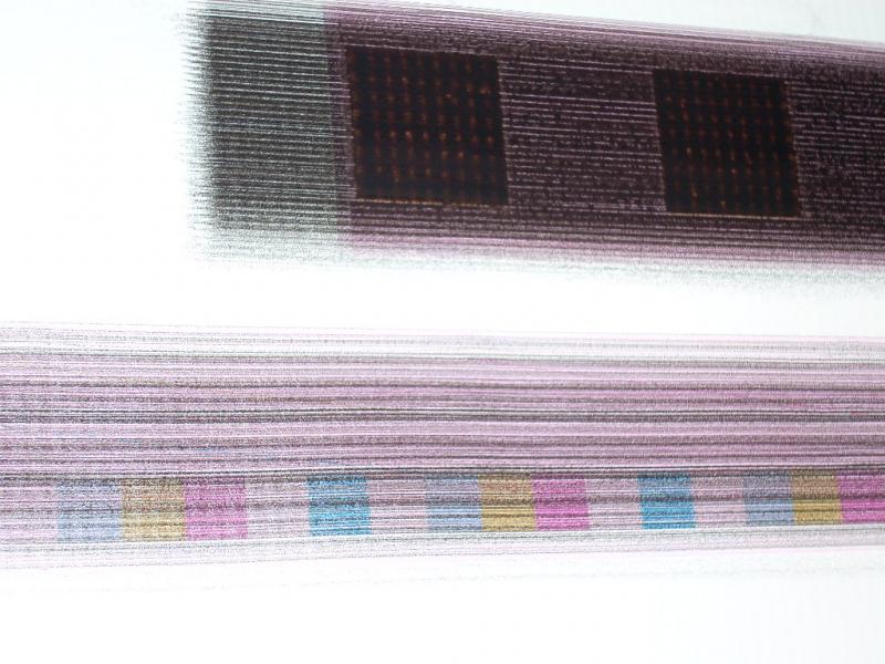

This is the result.

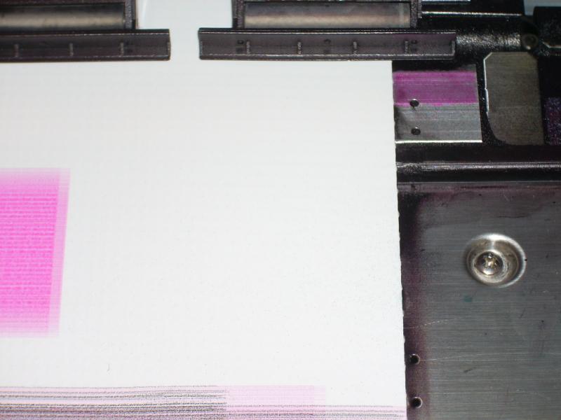

It is overprinting on the heater bar on both sides of the 60" banner material I have in it. You can also see it on the print that is supposed to be the orange squares.
Any and all help is very much appreciated.
Thank-you in advance.

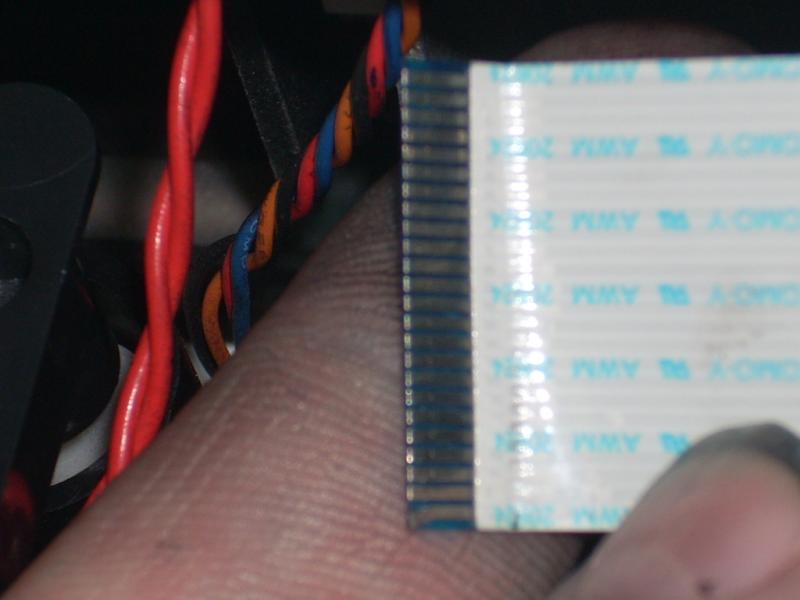

recheck that you seated the head cables nice and tight, and correctly - appears to be a data issue - hope you didnt spill ink on your boards while doing the head remove/replace...

The cable was seated tightly but has a "bent" connector on the bottom. It was that way when I took the head out the first time though.

I also flipped the cable around thinking maybe putting the bent pin in a location that wouldn't be getting pushed and pulled a lot. That did nothing.

Head is bad
You push to hard threw the head with a syringe you will blow the membrane. That a DX2 head. I did it on a DX4 head and got the same results. It seem that when you stick the head in an ultrasonic cleaner the head and vibration clean it nicely but when you push solution threw the head, that another story. I usually let the pump that attach to the capping station do the work and it work nicely. What I have learned cleaning dozens of heads that if you push cleaning solution to hard, it a death trap.... Except for Konica heads out of HP9000 or Seiko 64's printers. they hold up a lot better.
