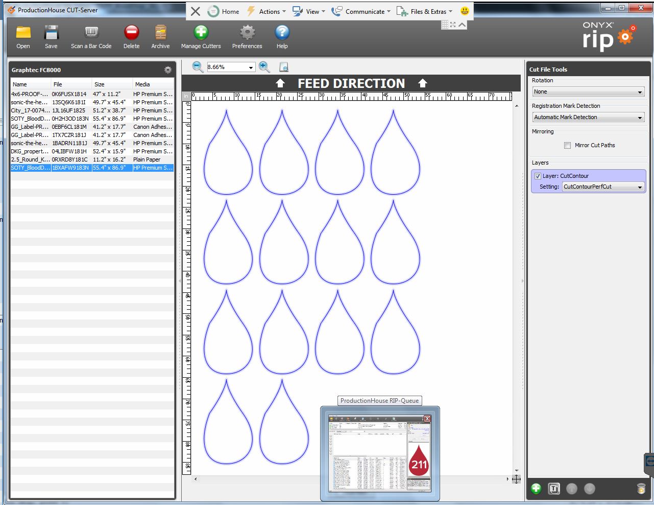

I have both ONXY and Flexi that I can use. Just want to strip cut after each row is cutcontour, is there a setting for this the be defined PerfCut, CutContour, etc...
Never use CM3 or CM4 since we get good cuts from Onyx, but have some small policial stuff and be nice to not have to cut it all by hand.

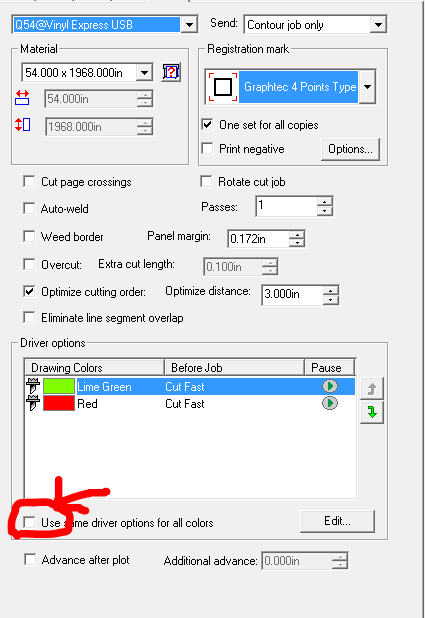

you could set up a new condition, I use #8, set the force hard enough to cut all the way through.
When you do the cutting, in production manager, assign the condition you just created to the lines you want to cut all the way through
then assign the cut order.
Always use different colors for contour cutting, and cross cutting so they can be assigned to different conditions.

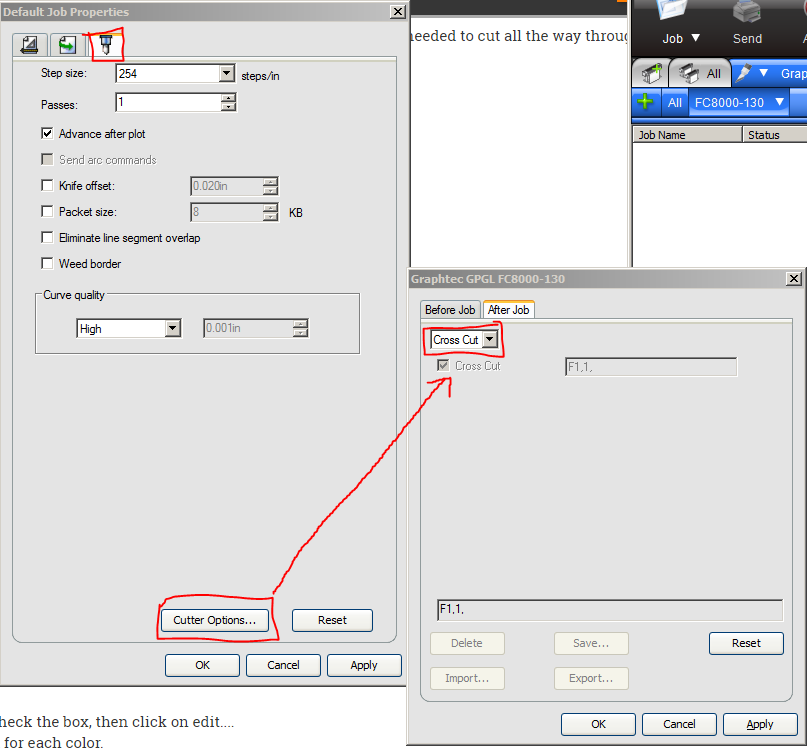

You could also, in production manager, assign the conditions needed to cut all the way through (without setting up a condition in the plotter itself...
Uncheck the box, then click on edit....
do it for each color.

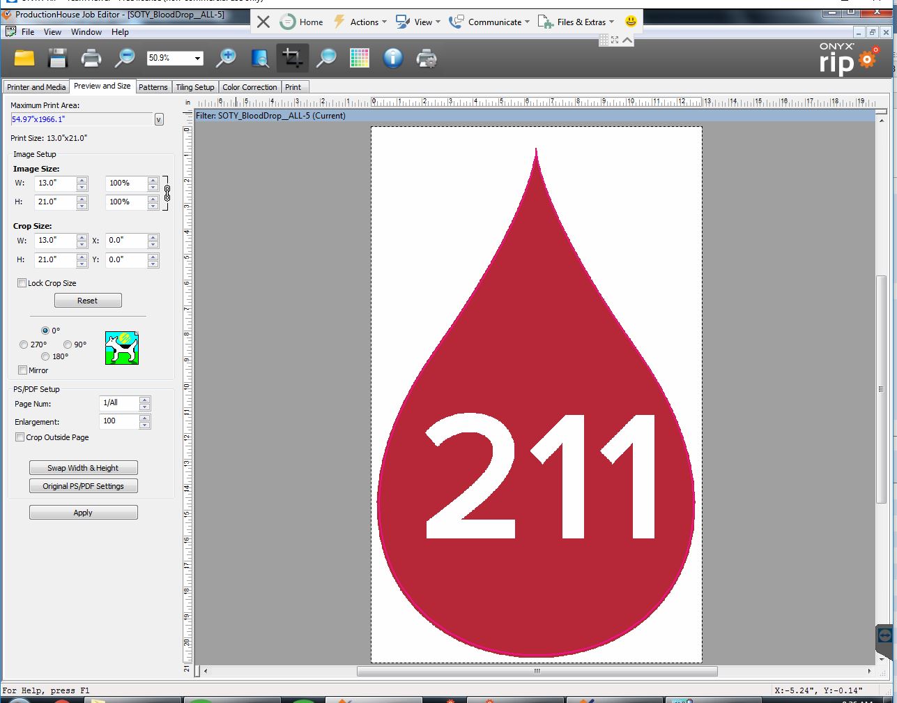

Flexi always seems like more work... When i define CutContour in AI Onyx picks it right up, in Flexi i have to use the EFFECTS - Cut Contour, then set the marks. Hard to do any real volume in it.. unless i am missing something...

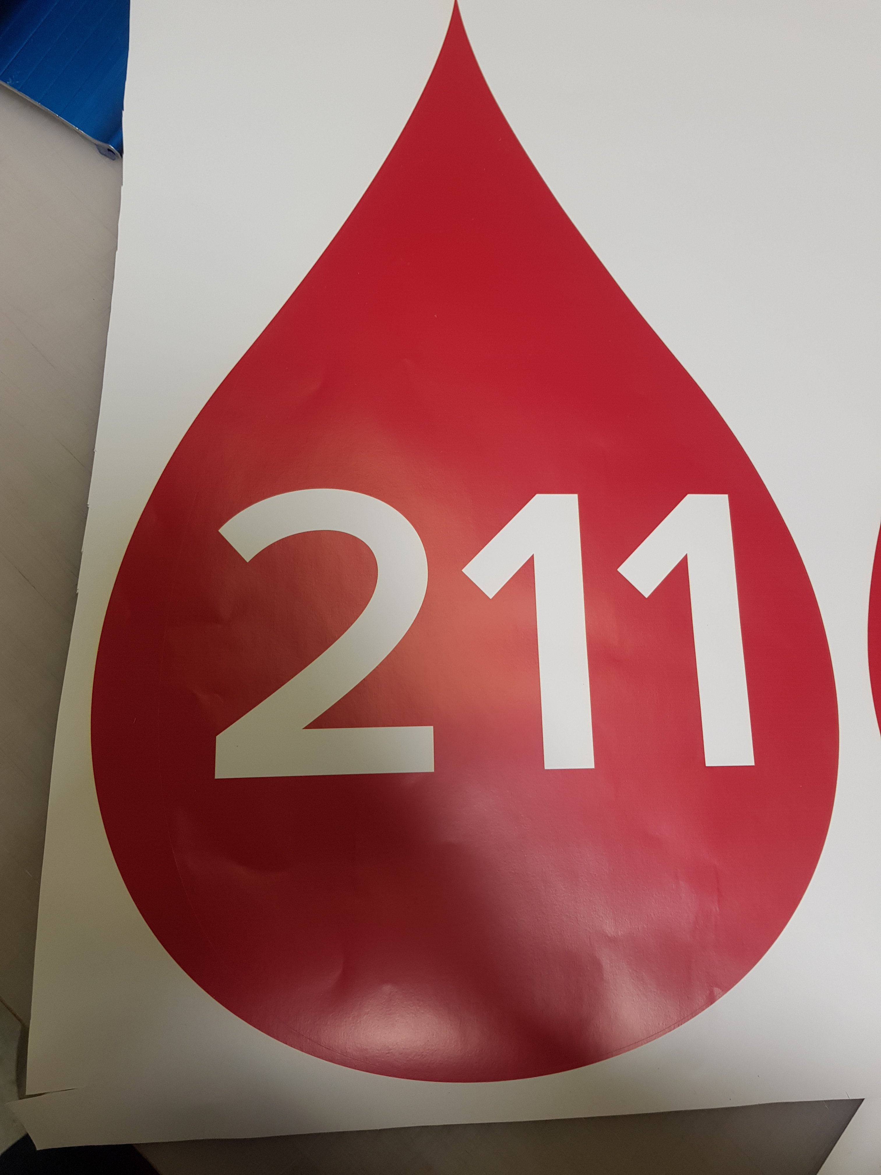

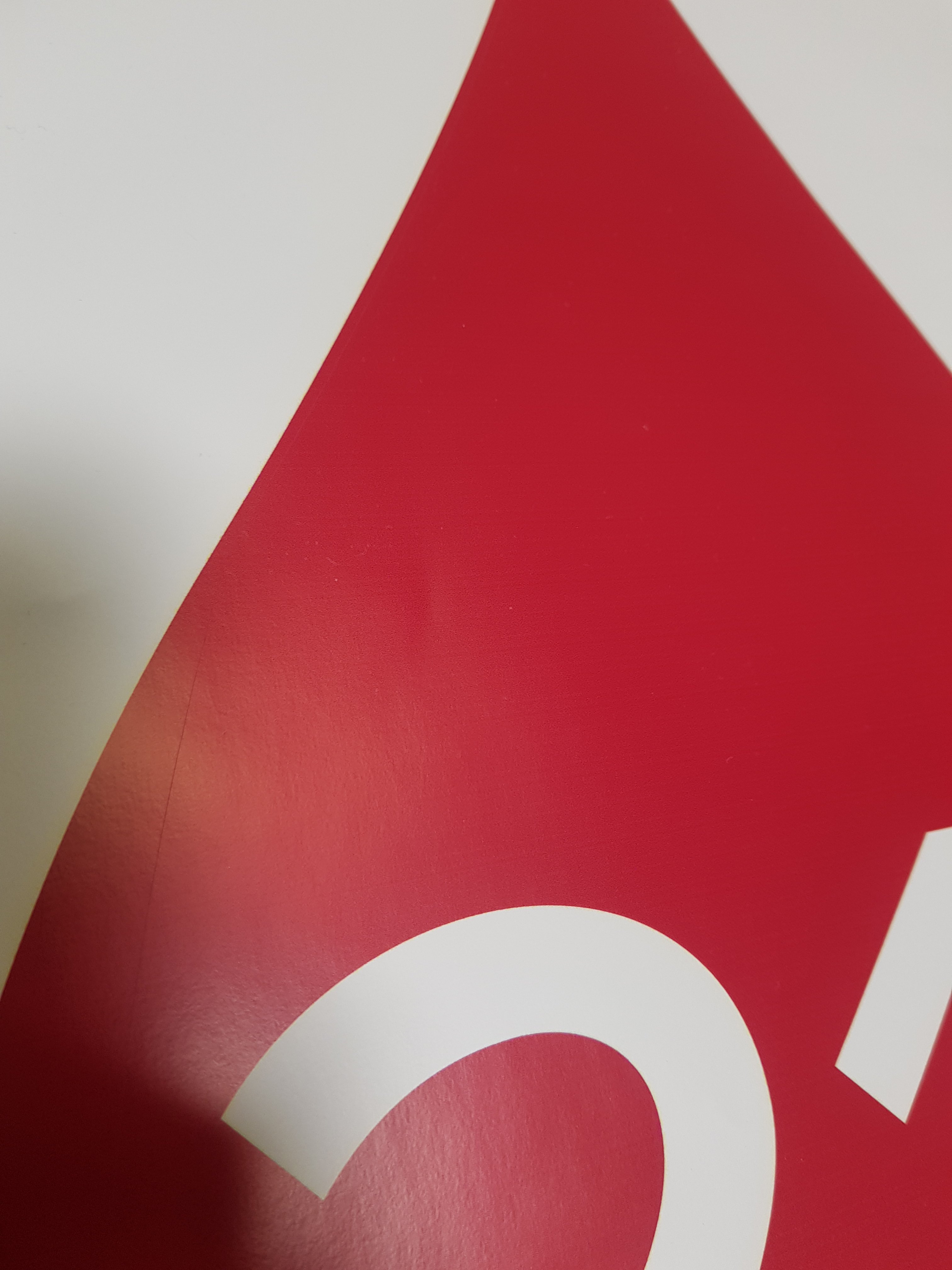

having issues cutting in general.. Just installed AI 2017 and cut master 3, to try to narrow it down.
Why would the plot be off so much..
ARMS is working, looks like it start out dead on...
Installing AI 2017 so i can try to use CM3...
