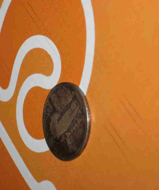

Fine horizontal lines near one roller?
Bogie
Not banding (that goes in the _other_ direction...), but it looks like maybe the rollers are picking up ink or something... Several little hairlines after a really dense area.
How bad's this news? Part of the heater? Roller?

Bogie, if you have rollers like ours does, you should give them a quick cleaning when you clean the capping stations and such, they always tend to get a little greasy and sometimes pick up hairs/dust and such. Have any picture of it to post?

Oh yeah - the lines are fairly uniform, and look like they are made by some sorta multi pizza cutter... Can't really see a lot around the rollers, and I'm thinking that they're buried somewhere in the maintenance manual, cuz I ain't found 'em yet...

Okay - degunked the bejeezwhozis out of 'em, and the q-tips are coming clean, so something else is going...
Yup. Didn't solve the problem...
Actually, the lines look sorta multi-colored... but each line is also straight... Could this be some sorta headstrike? Picture enclosed, and I included an old quarter for scale...

look underneath on the head carriage, we get lines like this when some lint like fuzz has built up on the heads. Sometimes it has more then one color because more then one head has some fibers on them. Have you run any banner recently? The scrim fibers have been notorious for causing this. Take a look underneath.

Also, if the head's crudded, why isn't it doing it all the way across the vinyl? Why just in the one area? The lines are perpendicular to the head movement...

...yeah, regarding your other comment, I think George may have overlooked that perpendicular orientation... I think the fuzz factor creates marks parallel to head travel.
Have you trouble shot this issue with various media?
Is that photo a banner print, or vinyl, or?
I've seen banners with bad spots in the weave that pick up the ink differently, so I'd be curious if the lines correspond to the weave if it's a banner.
As far as the uniformity of the lines, do they match your roller placement? I know you thought the roller could be to blame... even though cleaning didn't help, do they line up?
Even the slightest expansion of a media, from humidity etc, could result in very slight puckering of the media between rollers, & this could result in a very very slight head strike, recurring in every pass, over each puckering spot. I'm thinking this is a long shot guess, because I don't know how many stripes you are getting... but just trying to keep the ideas flowing.
Jackpine
Clean around the edge of the print head with a foam swab and cleaning solvent or 91% denatured alcohol. Just clean around the heads not the print head itself. I believe this is a Mutoh Jr....so set the vacuum on the front control panel to high. It looks like what iSign stated...very small head strikes. The Mutoh's rollers are under the media. It is not roller marks.

Did it on thinish vinyl too... I'm thinking that you may be right...
