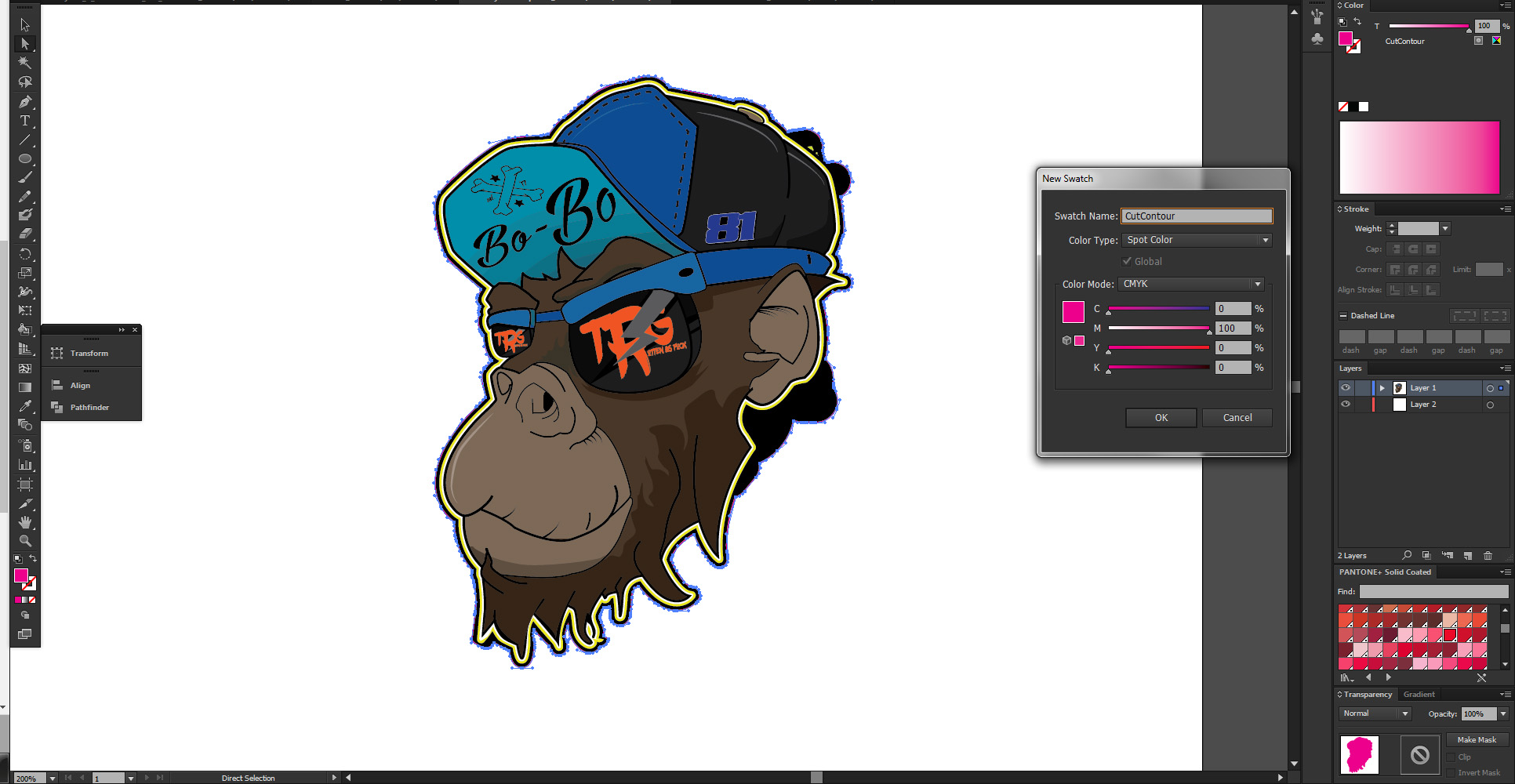

With Rasterlink you can setup the file just like a Roland does instead of using cutting software. You create a sport color called, "CutContour" and then set your cut path to that color (usually 100% magenta but you can use whatever you want). Then save as an EPS or PDF and open it in Rasterlink. It will see both the print and cut data and you can just print and cut from there. Cutting only does not work so well this way for some reason though and that's where Finecut or another cutting software might help.
Edit: I should clarify that you setup the spot color in Illustrator not Rasterlink. I just re-read and confused myself!

so what your saying is essentially, create a cut line in illustrator on its own layer, and make it a spot color that is easily identified by rasterlink, then import it as a eps.. Ive tried this but the "Cut " options under raster, raster and print ... etc are always never available ( grayed out ) .....

We all started somewhere. Double click on any swatch in your color swatch tool box and it will pop up with some options. You just need to make sure it is set to Spot Color instead of Process Color and then in the name box make sure it says CutContour with capital C's and no spaces. Then save an then open in Rasterlink. If you do it correctly, the cut options will be available.
