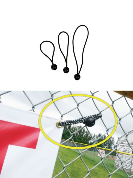

We use bungee balls sometimes for banners on chain link. Simple elastic loop with plastic ball.
