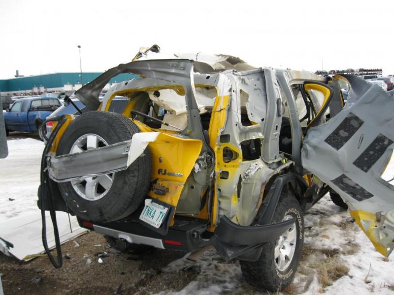

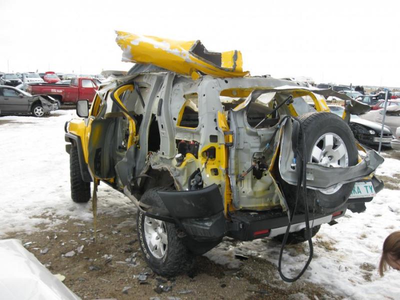

A little acetylene might work...
Full Story
Instant vinyl removal...
SignBurst PCs
Full Story
I saw this on one of the FJ forums! Crazy stuff and the fact that he wasn't seriously injured is amazing.
