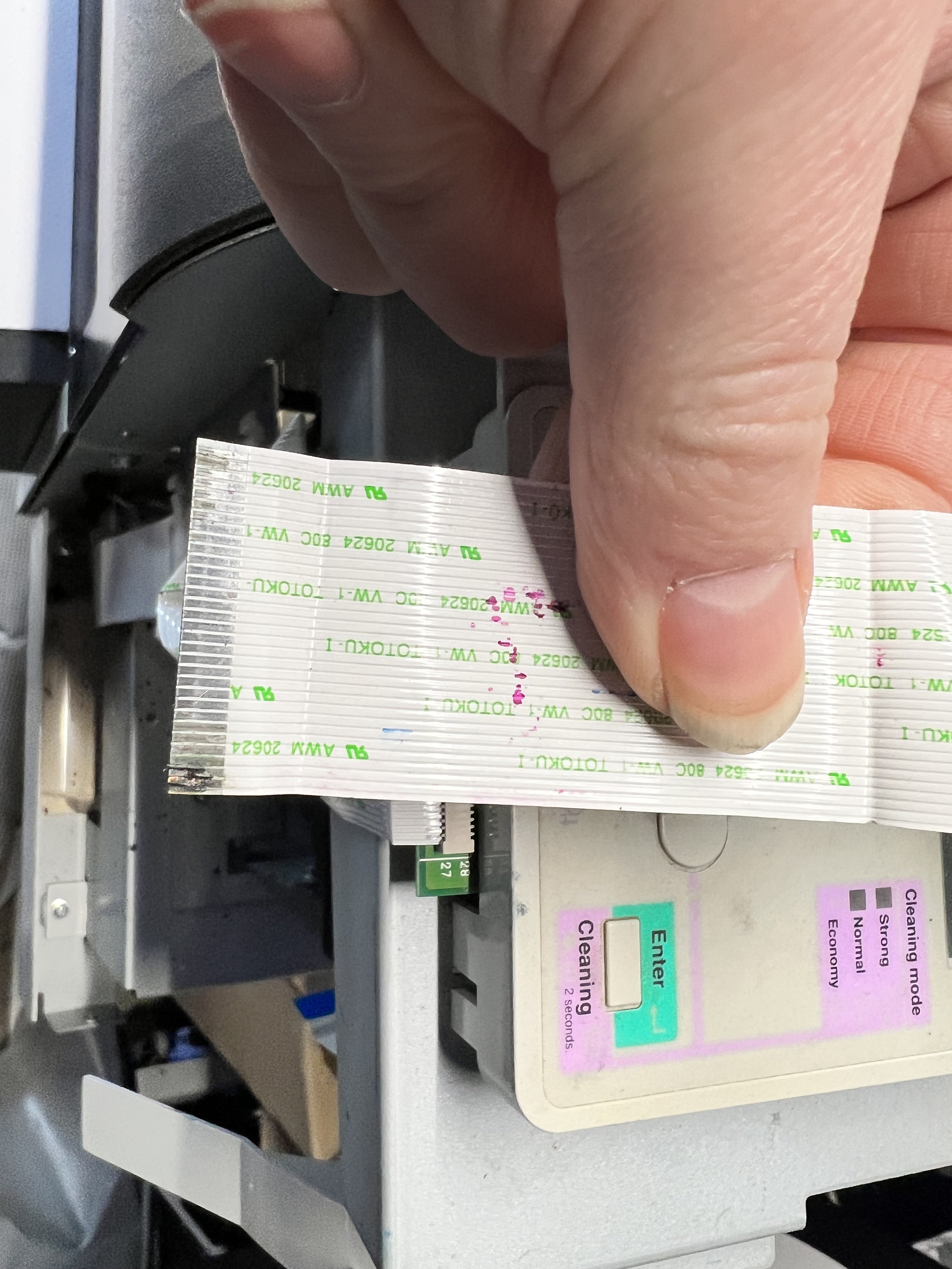

Hi guys where can I get a 31 pin flat cable for printer head
for the mutoh 1304 valvejet any suggestions
As you can tell from the pic one pin has blown when I turned the power on
Find many great new & used options and get the best deals for 10pcs Mutoh VJ-1604 / VJ-1618 / VJ-1204 / VJ-1304 Head Data Cable 31pin 40cm at the best online prices at eBay! Free shipping for many products!
you will probably need the roland fuse as well, if you can see visible damage on the cable
and i feel bad for not mentioning solventinkjet.com as a supplier for the ribbon cable
they can tell you whether you need th 1.6 a fuse or the 3.2 a fuse
