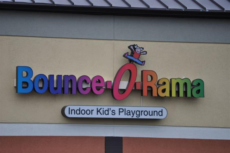

Absolutely! We do it all the time.
One of the best advantages to using a flatbed for lighted signs is that you do not have to double strike the face to get sufficient density when lit. You simply print the faces at 100% density, then print the back at 50% and, voila! You have a sign that looks great both day and night!
Ideally, you reverse print on clear and either put a second backer piece of white in or back spray it white with grip flex or some other sign face paint of your choice.
