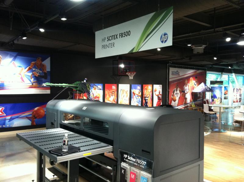

Here are a couple photos from the HP demo center. First class facility.
