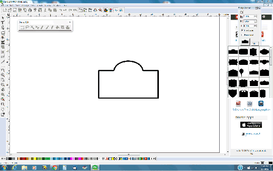

Unless I am misunderstanding the question, there is a whole slew of sign borders in Flexi that are easily manipulated and outlined etc. Is this what you meant?

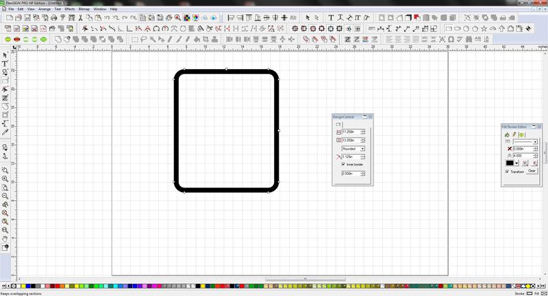

Square tool. Make sure the Design Central is open. Click on the square/rectangle tool. Set the size of border, radius, and inside border. Really Really easy for MUTCD signage. This is the best program for traffic signs out there.
BHere is a picture
