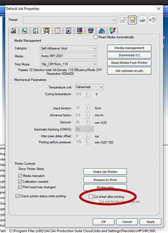

This seems like this should be a super simple thing to do. After my job is done printing, I would like my printer to automatically cut that job and start printing the next and so forth. Where would I find the string to do this. Thank you!

The setting is in the production manager for cutting after printing. Check the tabs for the profile in question.
karst41
From the PM go to the printer properties button that the top left or the PM window.
This will launch a new window. The Cut Sheet after printing is a check box option at the lower
LH of this window. You "Must" click APPLY.
For printing you really need to look at "ALL" of the features in this window.
When Applied the features you select become the default properties until you
go back in and change them.
