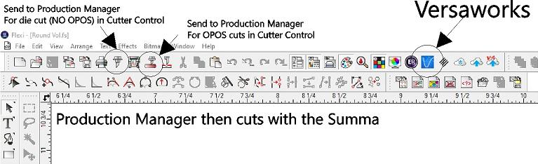

I have the same set up as you (VF@-640, T-75, and T-160 OPOS) and I print to Versaworks because the profiles are great. Just because you use summa, doesnt mean you cant print through VW. ALL my prints STILL go through Versaworks. (If using OPOS, make sure Cutter Control is open in background)
Unless you purchase an X-Rite and set up your profiles yourself, I doubt you will get a good print from Flexi using that route. Let VW do what it was made to do by your printer manufacture.
Dale D
1. When purchasing Flexi, you need to tell them that you want the Roland Versaworks version. They also have a HP version as well I think.
For OPOS, I print with Contour Cut marks in VW, then remove and place in T-160. Send job to Cut Contour, Production manager opens. Once job is sent, Summa Cutter control will beep telling me to align the bottom right mark. Align it on machine the n press check mark on machine. It will then cut using Summa. Just make sure Summa is running in background.
