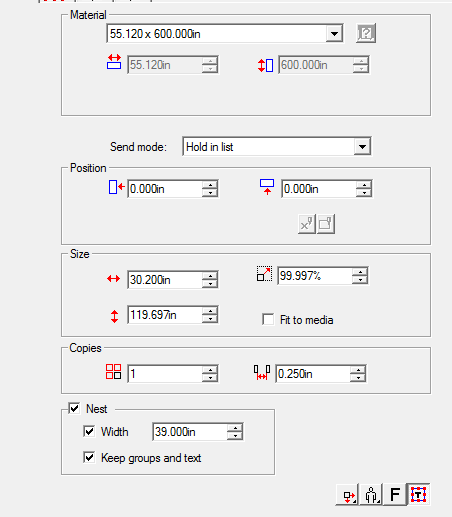

When trying to send a file to my Summa S140-T in Flexi, it won't allow me to scale the graphic to 100%. If I manually enter 100%, it will automatically change it back to 99.xxx% (it varies). On small cuts this doesn't make much of a difference, but on some bigger cuts, it adds up to enough to ruin the job.
I have attached a screenshot of the problem.
Signchief
You could try to restore your preferences by going to "SAI Production Suite" under "All Programs" and click on "Preference Manager" you'll lose other settings in the process so save your current settings first by clicking on "Save".
