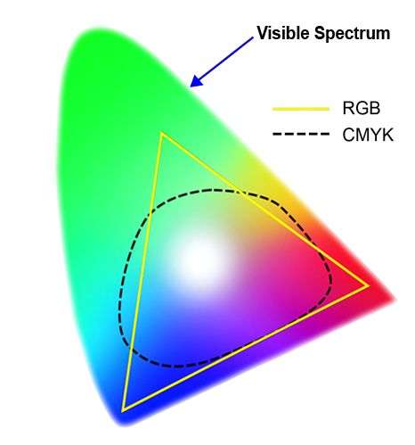

Kemble

Fluorescent colors are not printable with anything except fluorescent inks. These inks, and by extension, paints, are manufactured from particles that are ground to specific wave lengths. It would appear then that they are essentially monochromatic.
That being the case it isn't possible to obtain these colors by mixing conventional pigments of any hue.
It is sometimes said that these colors do not appear in nature. This is generally correct but witness a good sunset sometime. All the warm fluorescent colors are represented from time to time. The greens and the blues are another issue. Most likely these do not appear in nature.
