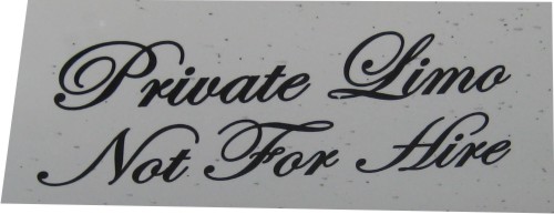

Anyone know this one?

I'd agree, looks a lot like Edwardian.
The stuff needs a fairly good contour applied to it to cut well, just did some for a vehicle graphic, think I applied around a .05" outline in Corel with rounding options and converted it so it wasn't so blocky from the regular contour. It still wasn't the funnest thing to weed. You may also want to do some node adjustments as well, because the letters don't quite line up straight.
