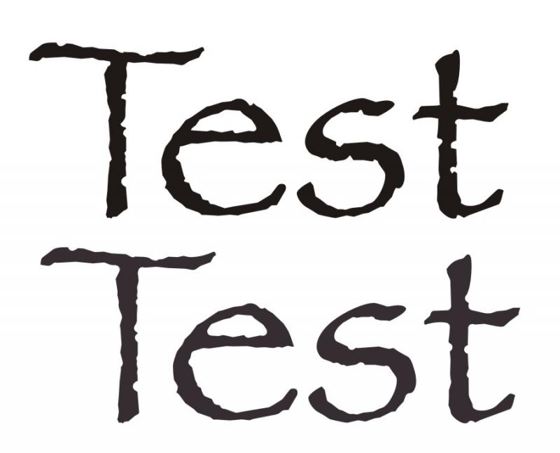

I am being forced into making a sign with the font Papyrus to match a customer's logo. the big problem is it will be for router cut plastic letters. if there a font that looks like that awful looking Papyrus font but without all the nasty jaggy edges? I sure hope so or I have to go in and clean up this mess so it will work.
thanks
J Hill Designs
doesnt work as well as i thought =/
Marlene
thanks, that will help speed up the process of getting rid of those jags. it may not work all that well but it's a start.

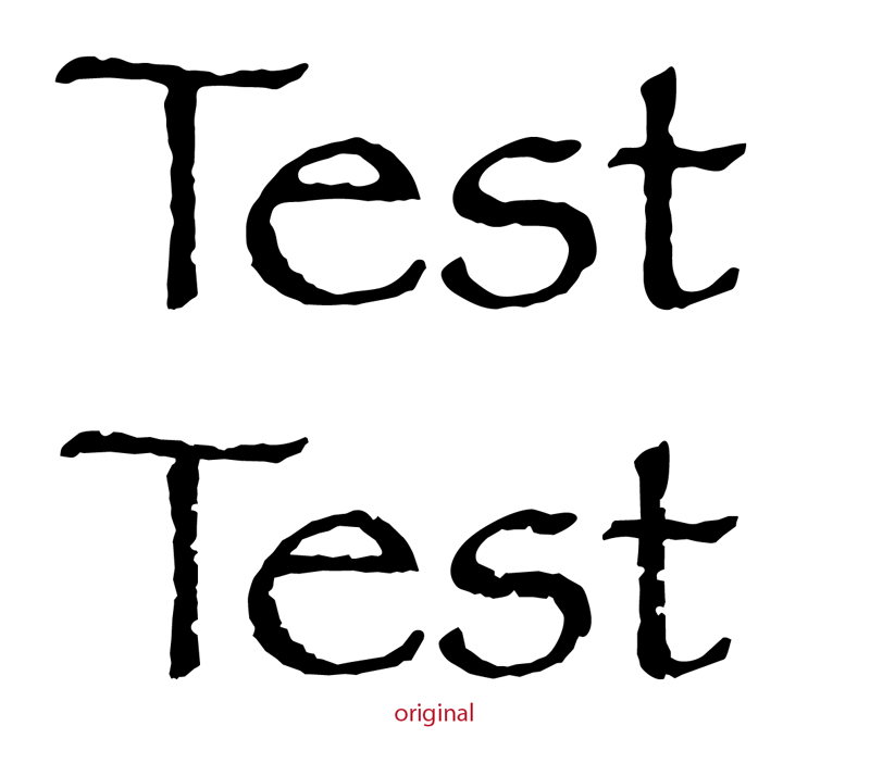

the larger you do the initial offset, the more of the jaggies you will remove, see attached.

I did the outline/inline and then did the smooth and it worked pretty good as it keeps the horrid shape of the letters without all the jagged mess that is Papyus...I so hate this font! it is the font you see every want-to-be designer thru in these days. but on the flip side, it could be worse and be Brush Script or Comic Sans:Big Laugh
