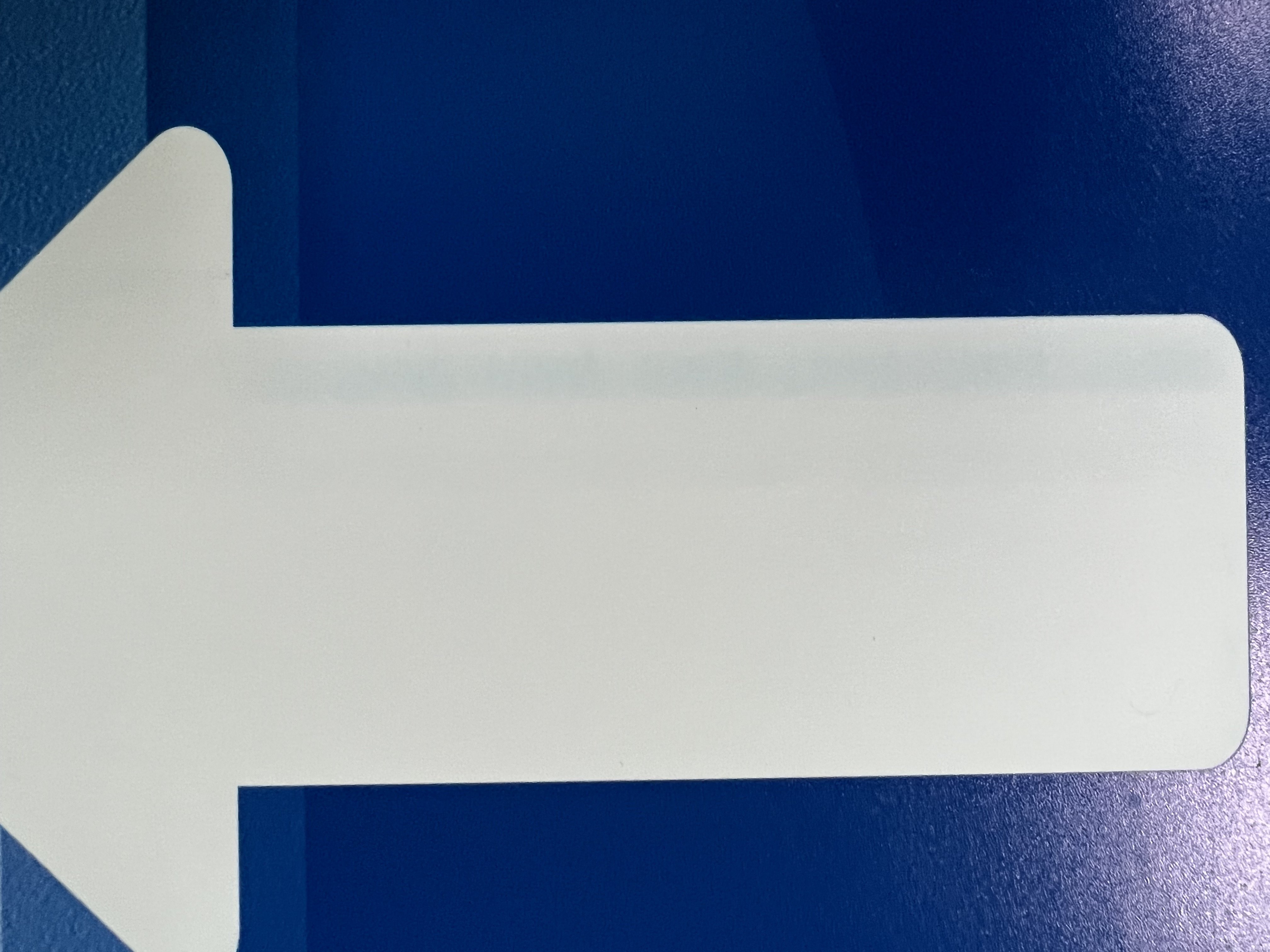

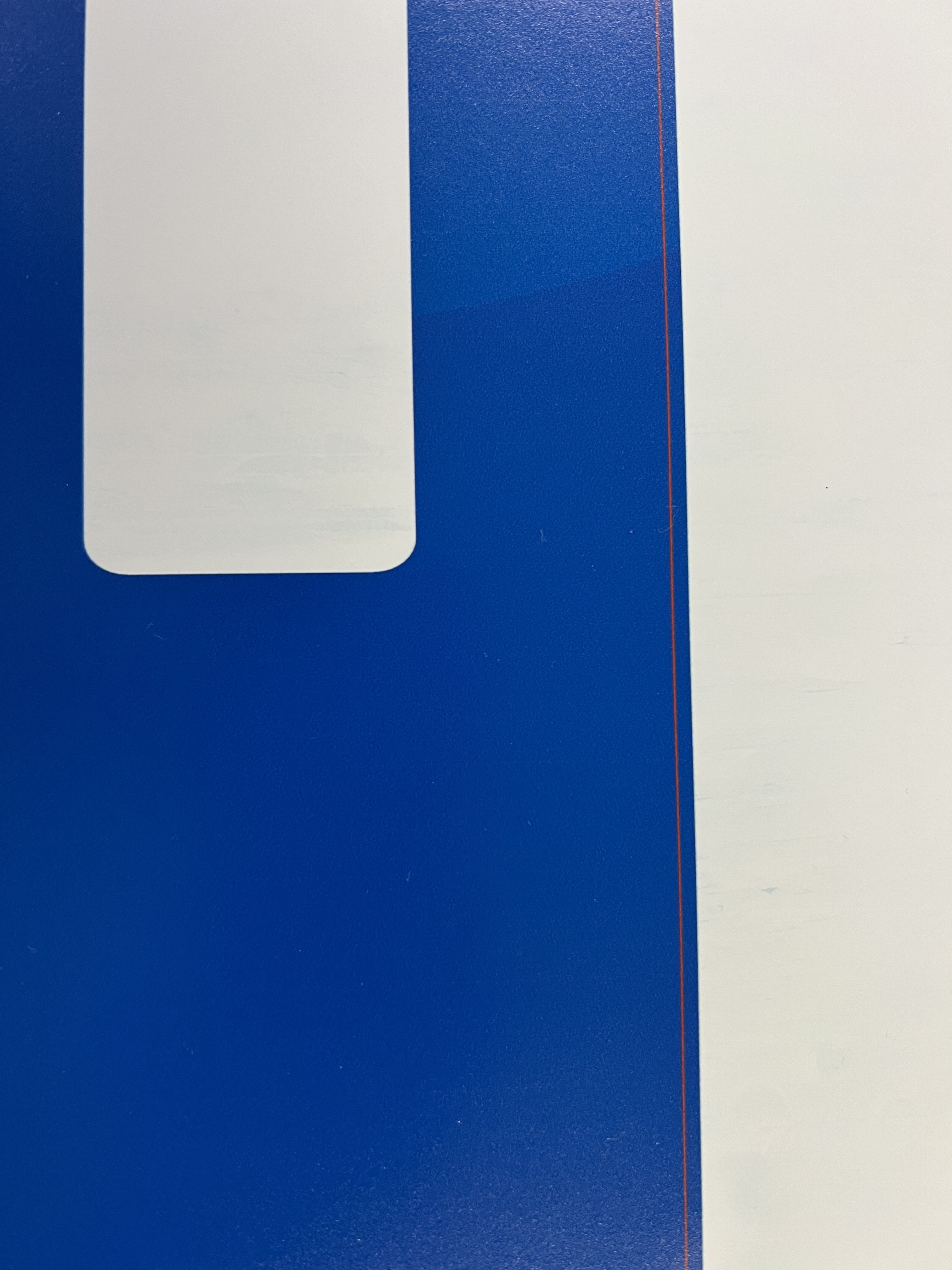

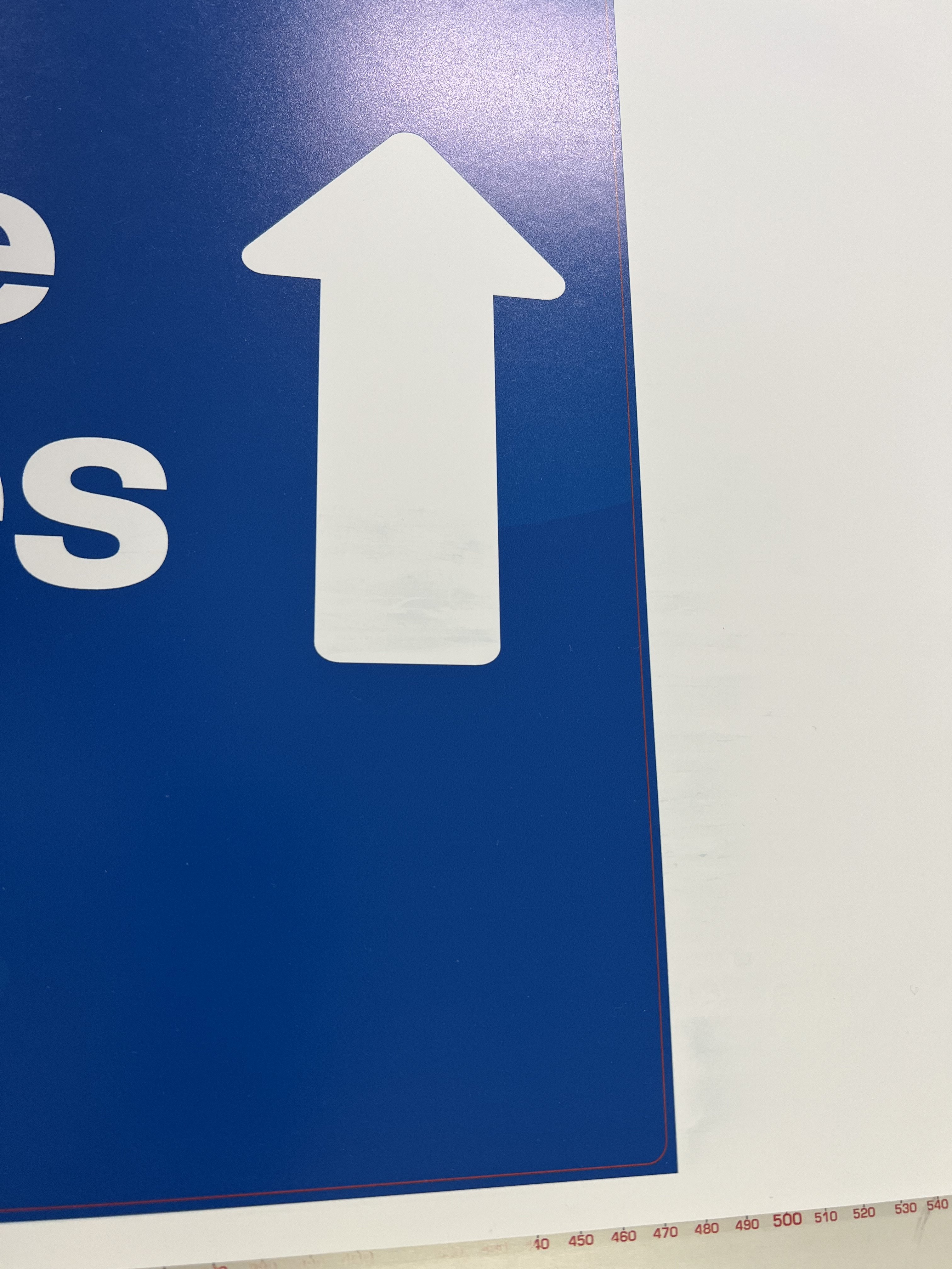

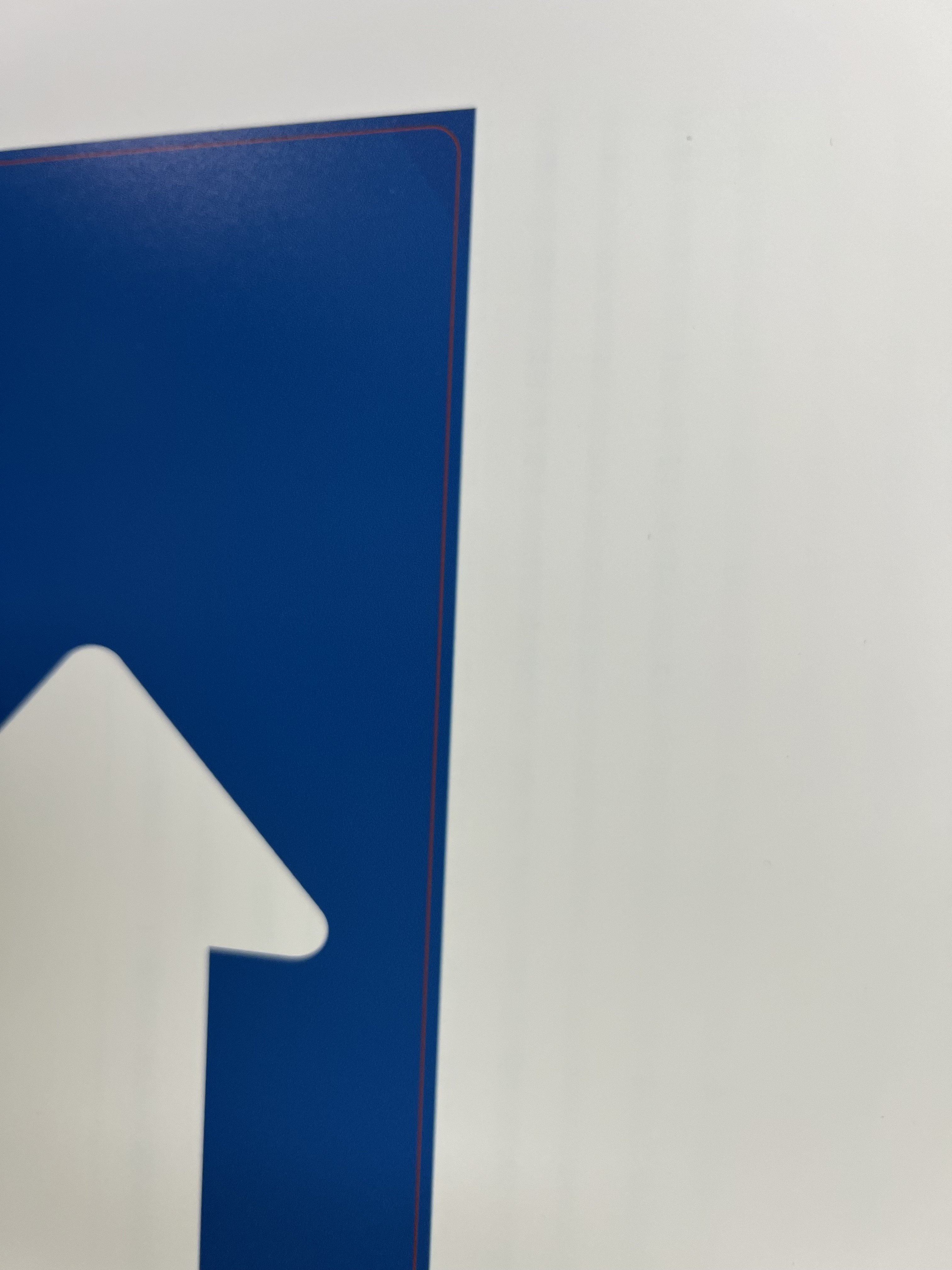

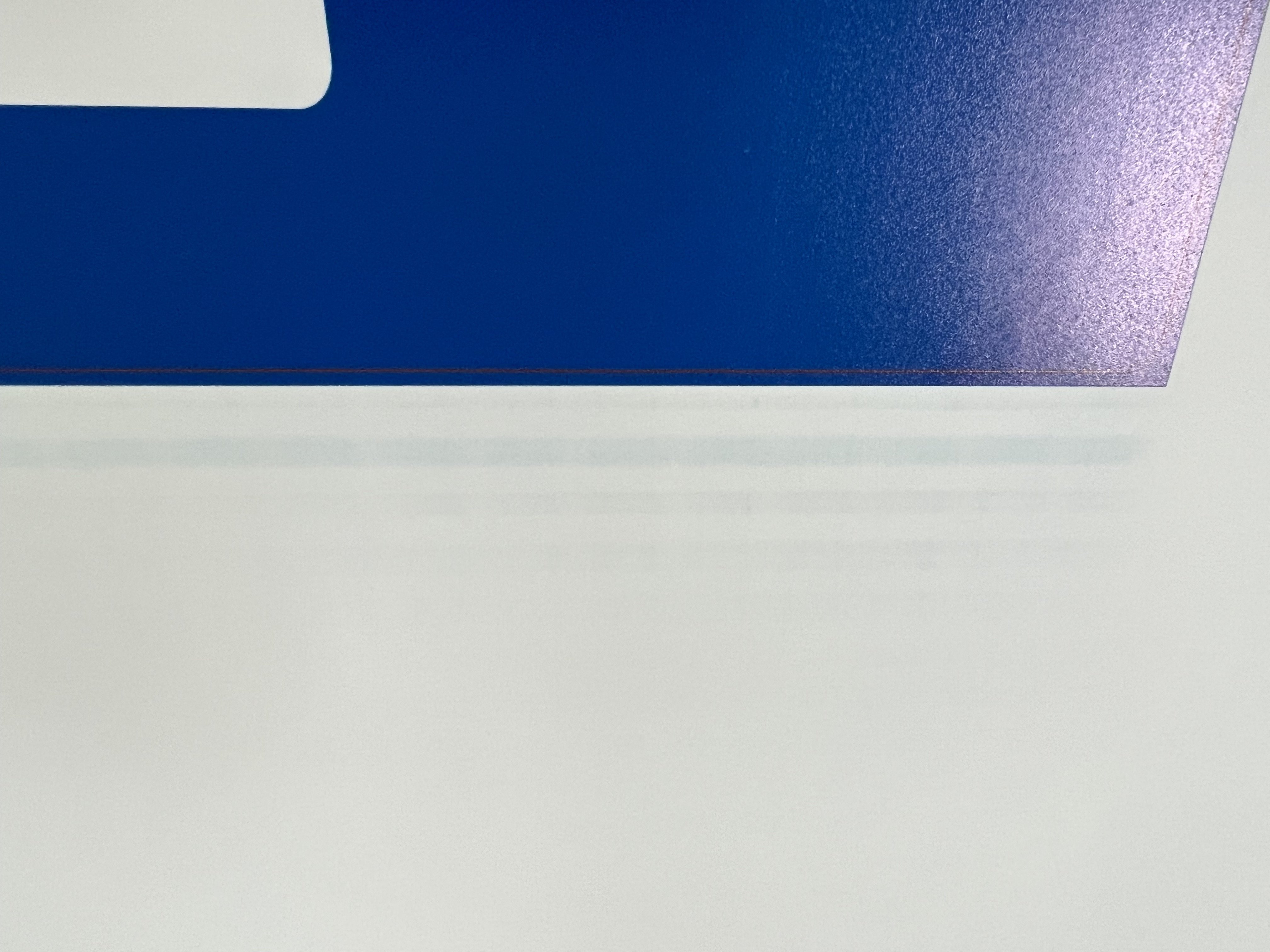

Hi guys and gals we have Fuji Acuity UV flatbed printer. We have had nothing but problems with this thing for over 2 years. When trying to print on gatorboard we get overspray. See the knockout areas. We turn on the static bar and it's much worse. Our humidity is around 55%. Boards have been acclimated for 48 hours. We have tried using anti-static spray, unidirectional and alcohol. Any ideas......???? Thanks!

Hi, The height is right at the board level. On paper and foamcore is prints great. I don't feel any static but a previous operator would get shocked by the table all the time. If I had hair I would be pulling it out!

Ink set meaning production or quality? I have tried both. Nozzles and head are fine. I know it's static!!!! I am told the table is grounded.
Today I tried:
Board acclimated.
Sprayed anti-static on the table.
Wiped the board with a swifter.
Humidity at 55%
Moist rag on Gantry.
