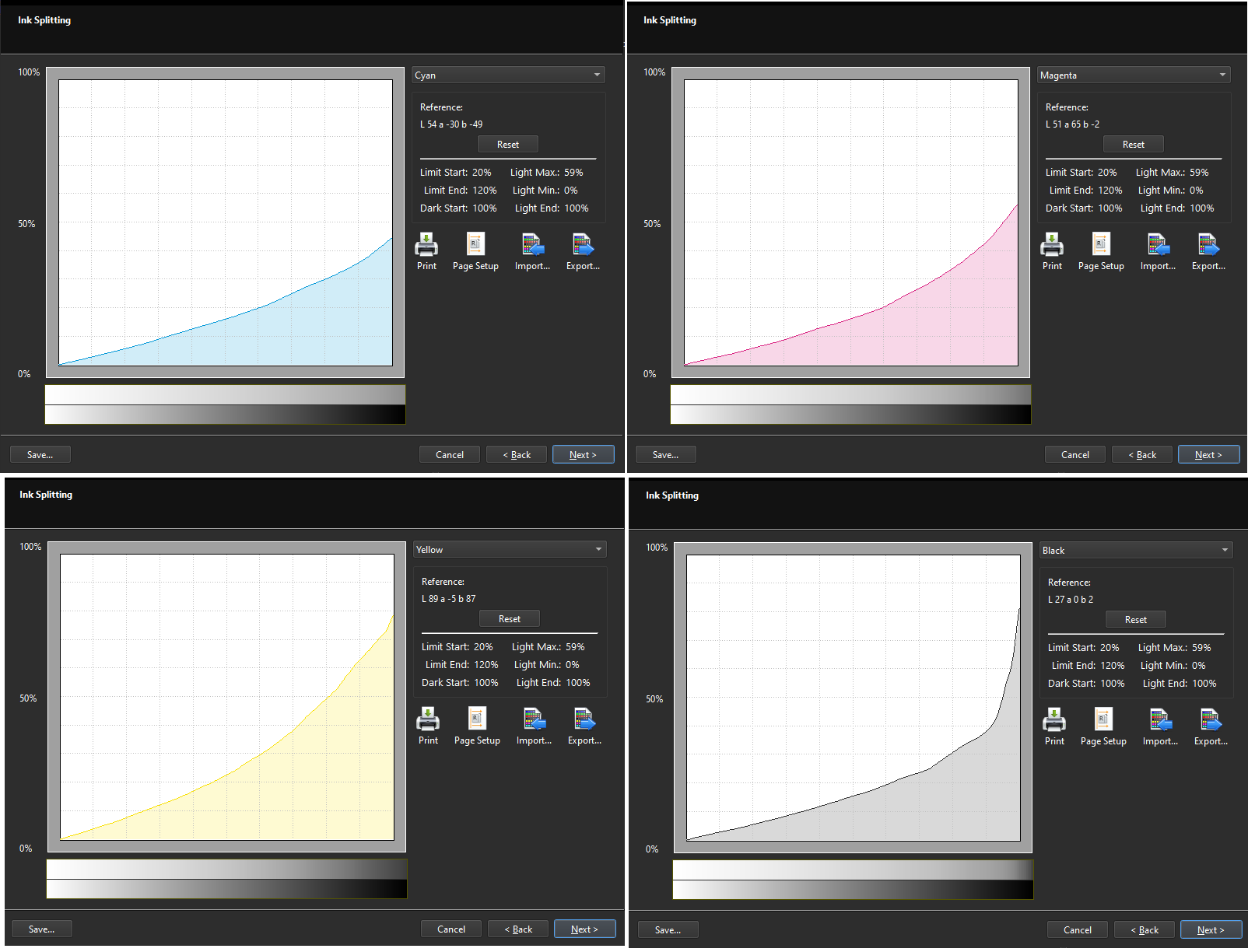

titmouse
Hi. I am not familiar with the Print factory profiler, but the essence is the same for everyone. Attach a photo of the black and total ink generation settings. Usually on uv total ink in the region of 220-280%
I'm not entirely sure which of the settings I should send a pic of, so I'll just send whatever I can export.
The little peak at the end of the K splitting curve does seem like it may be relevant, but I don't think I can actually edit that curve now.
I have no idea what "splitting" even is anyway.

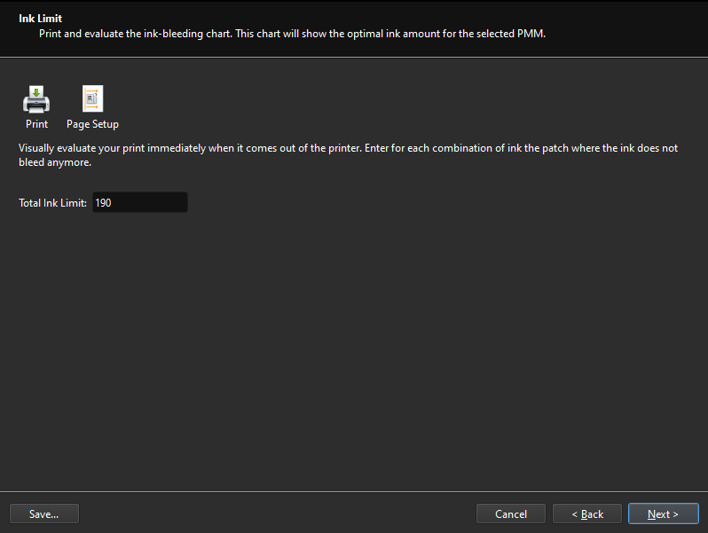

The total ink limit for this profile is set to 190%, I've also experimented with profiles with a lower ink limit (170-180%) which does seem to help a little bit, but the sudden transition to black is still very much there nevertheless.
As far as I've seen, I can't seem to specify an ink limit per channel, but I may not be looking in the right places.

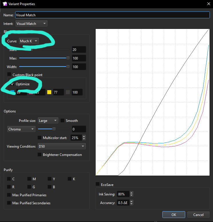

titmouse
"curve" select GCR, remove the "optimize" option
Optimize is already off, that part of the window is only used if Custom Black Point is on.
I've tried using GCR before and it didn't seem to have much of an effect, unfortunately.

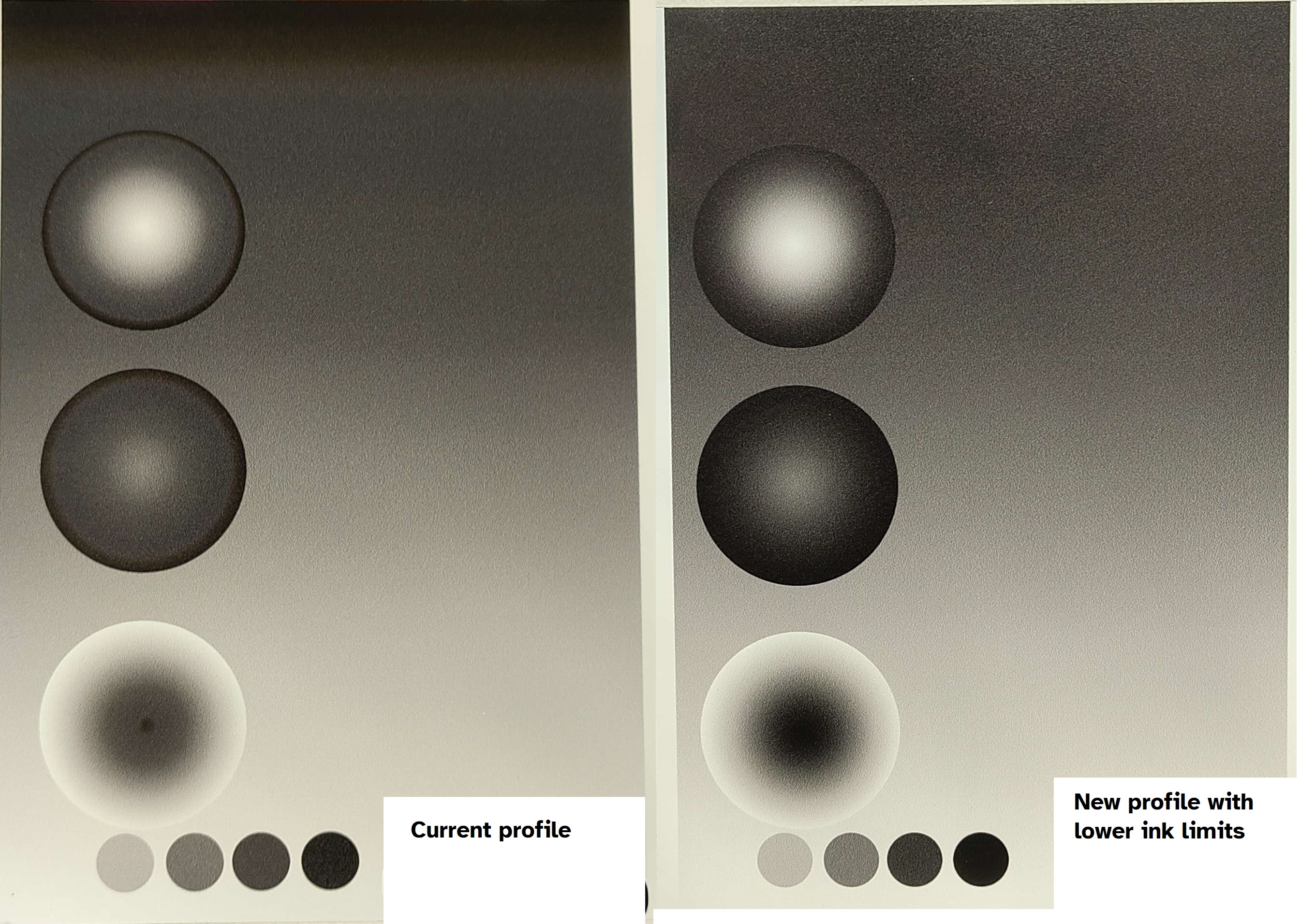

Update. I've made a completely new profile from scratch and this time, adjusted the ink limits. A printing buddy gave me the tip to check the per-channel ink gradients with a spectrometer and take note of where the chroma levels off, then set the ink limit there. I've set my ink limits to 80/80/80/60 (total ink limit is 153), did a calibration and some test images.
The results were absolutely horrifying:
I checked on all printers, using the production calibration. All of them look like the left print. Whereas the profile I just made yesterday (on the right, with lower ink limits), looks much better. No weird dark border, an actual proper gradient, better contrast.
It looks like the original calibration that was demonstrated to us by the supplier never was made correctly. At this point in time we knew nothing & assumed the guy who they sent over (whose sole job was color management) probably knew what he was doing.
And apparently we never actually recalibrated from scratch and never touched the per-channel ink limits either.
I have no idea how we haven't found this sooner, it seems obvious in hindsight.

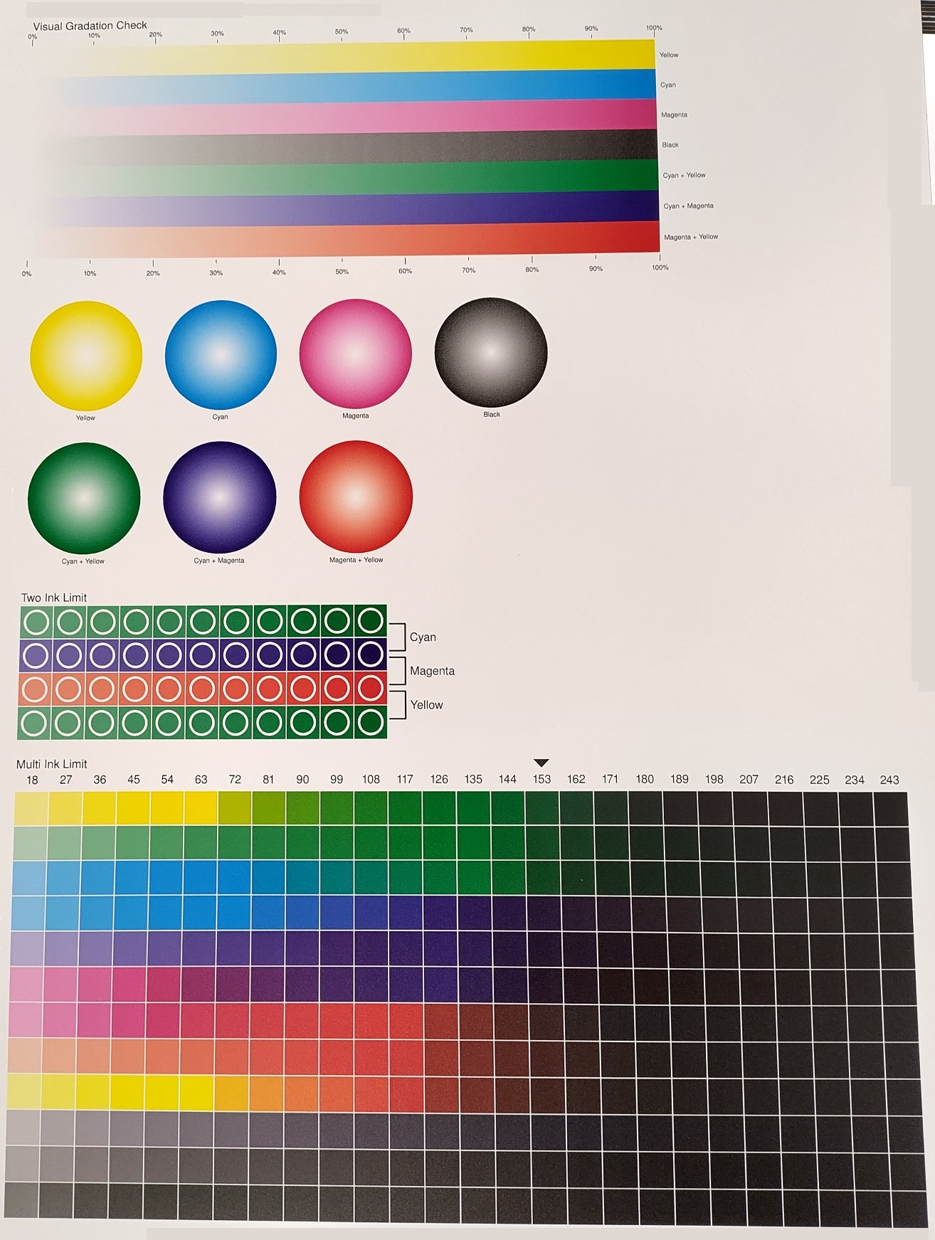

In any case, I got a total ink limit check chart at the bottom of this photo and I'm not sure how to interpret it. Should all color channels fade to black at the same column? At what color do I set the ink limit (ie. what on this chart is good, and what isn't)? Or should I set it to the point where channels reach their maximum chroma and brightness? There's no documentation whatsoever, so I just used the ink limit suggested by the software, 153.
(I think yellow is still a little bit too high, given the banding visible on all colors where it is used)
swordguy3222
I use ColorGate, so not sure how Printfactory works, but if I base what I know from mine to here then you should have your limit set around 189 or 198. You want to set it where there is no more visible change with any of the colours. With CG I have it set to 300, and mine looks like your 189.
