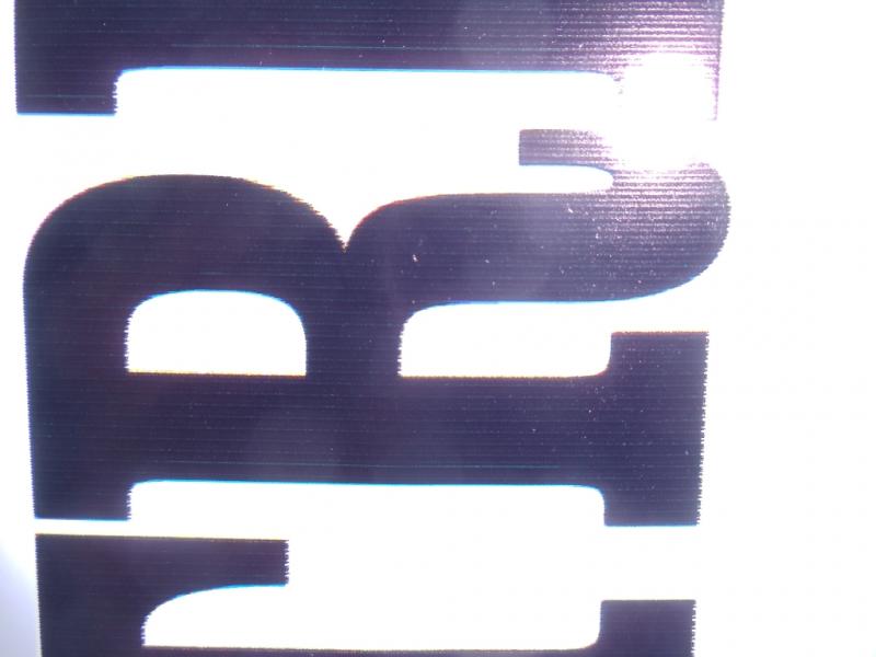

Does anyone know how to get rid of this fuzzy edge? It only happens when I print black.

looks like it's bleeding. i'd name whatever rip you are using. there are some rip gurus that will be able to guide you through the correct density adjustment.
gixxer2004

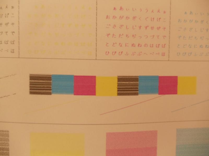

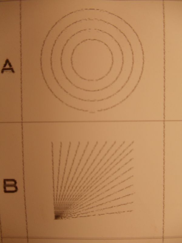

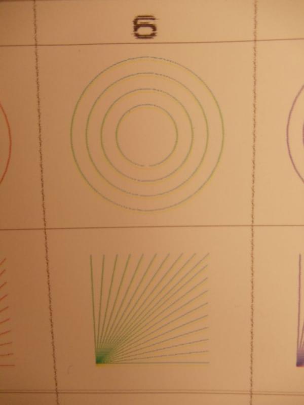

I don't think it is a rip issue because it is also doing it while I run a test print. I think it got out of adjustment somehow. I included some examples of the test print. The horizontal black lines are clean straight lines but the vertical lines are real fuzzy which is making my letters look jagged or fuzzy. The black print head needs a good cleaning to get rid of some of the lines.

You have missing noozles, fix them with cleanig the print heads and the you need to adjust the printhead position (horizontal and high or low it depents what yoy are using)
