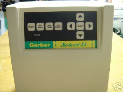

I purchase a gerber select 15 in great shape. But the problem is that I don't have the driver for it. I email gerber but they don't respond. If someone have this driver or the software this machine use and spare parts like swivel knife holder and roll tensioner please let me know.

Can you post a picture of what you have?
As far as I know, the only drivers you are likely to get for whatever you have will be in Gerber, SignLab or FlexiSign software. There isn't going to be a driver to run it from anything else.

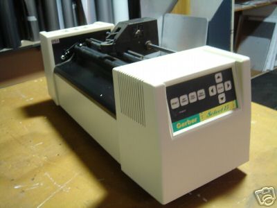

the plotter is very similar to the gsx.

I just checked my Omega plotter list and there is a Select-15 plotter listed. You will probably need a copy of Gerber Omega software to drive it though.

A GSX driver should work for it. You should check the pins on the sprocket. The Select could only use vinyl supplied by Gerber because the sprocket was different than the sprocket configuration of all others that uses punched material. A GSX sprocket will work on this to make it compatible with any punched vinyl.

yes the sprockets are different. Gerber offer me a conversion kit that I will buy soon. But the problem I have is with the driver for this plotter. I try all the drivers that flexisign have none of this work on the machine. I also have lxi software and the company send me the gerber drivers and they don't have the select-15, they told me to contact gerber but when I contact gerber they respond that I need to contact the software company.

Today I received the null cable and I try to test the gsx 15 plus hpgl driver and the plotter works. thanks for all the help
