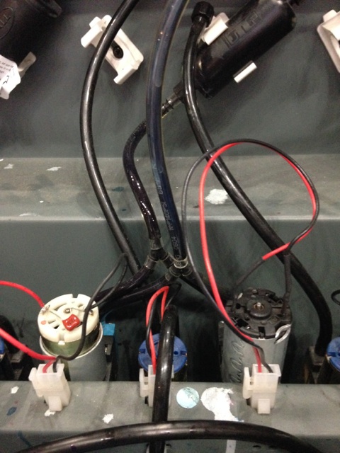

generally lines from the secondary to the head can introduce air into the lines. are you getting air in all of them? or just one head keeps giving you issues? is there a thin layer of ink pooling at the bottom of any of the heads?

this photo looks like ink pumps and negative air pump parts. air does not get into your lines at these points. the secondary tank has an air space at the top of it that has a mild/adjustable negative air pressure inside of it. this reduces the weight of the ink coming down the lines. which without it would just drip out under its own weight. these tanks also act as a damper of sorts (as on an epson solvent printer) to catch air and keep it away from the heads.
so air getting in the heads happens after the secondary tanks. do you have the little clasps on the unions from fittings to lines? i've seen those quickly get rid of a tiny leak that is pulling air into the lines.
