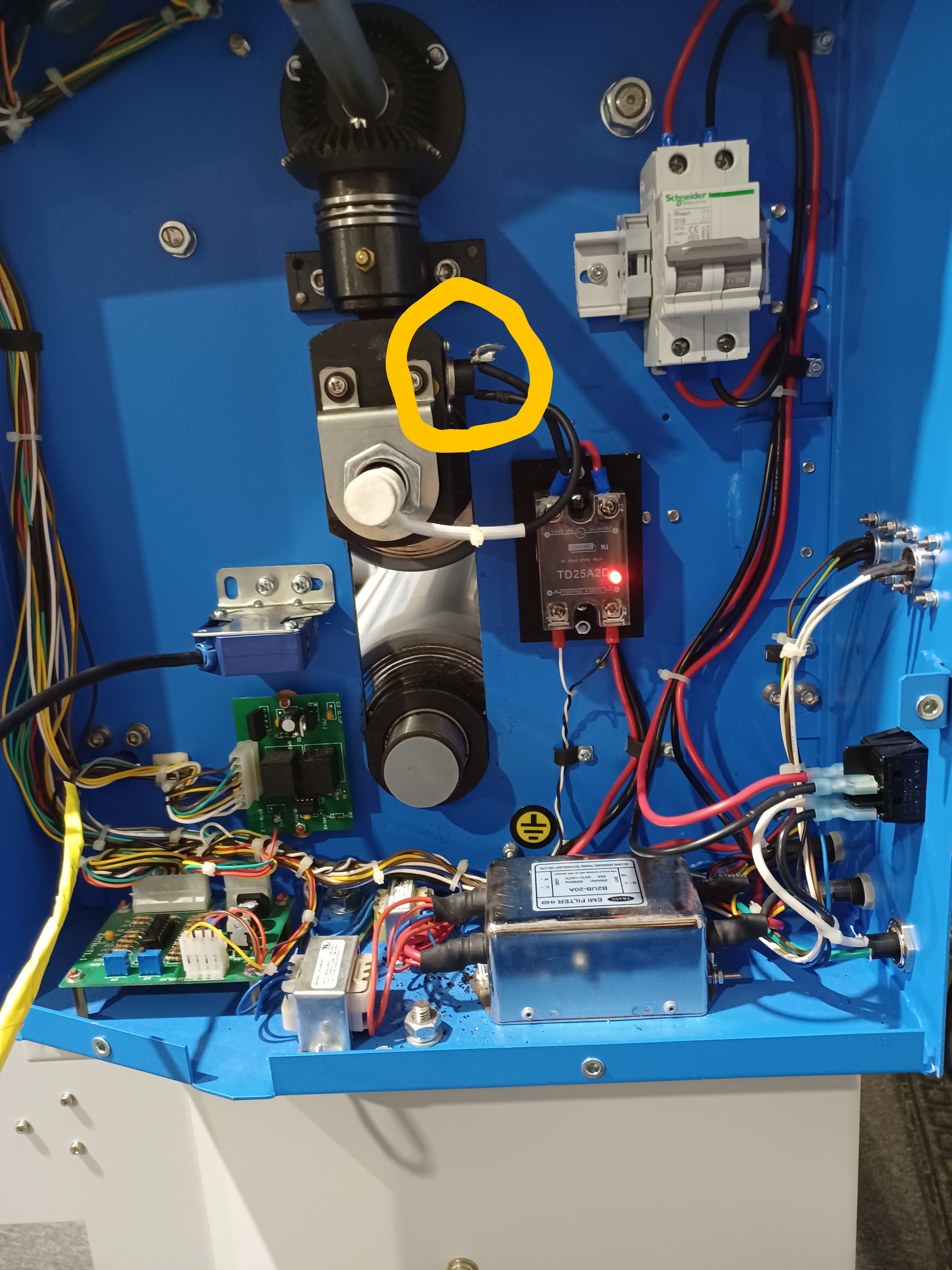

Our laminator we use for vehicle wraps quit heating up. I used it yesterday and it was fine. This morning I turn it on and turn the heat on, but it's not heating up at all. We have an extra laminator here for parts so we changed the heating element but that didn't fix it. We see there is a temperature sensor and will change that next. Just wondering if anybody else has encountered this problem. Thanks!

There's a screw in fuse on the back for the heater isn't there? I'd wager you've already looked at that if you've pulled the element, but ya never know.

We had not! But now that we have, they are good. We are going to try calling Gfp to see if they can help. Thanks for the advice though!

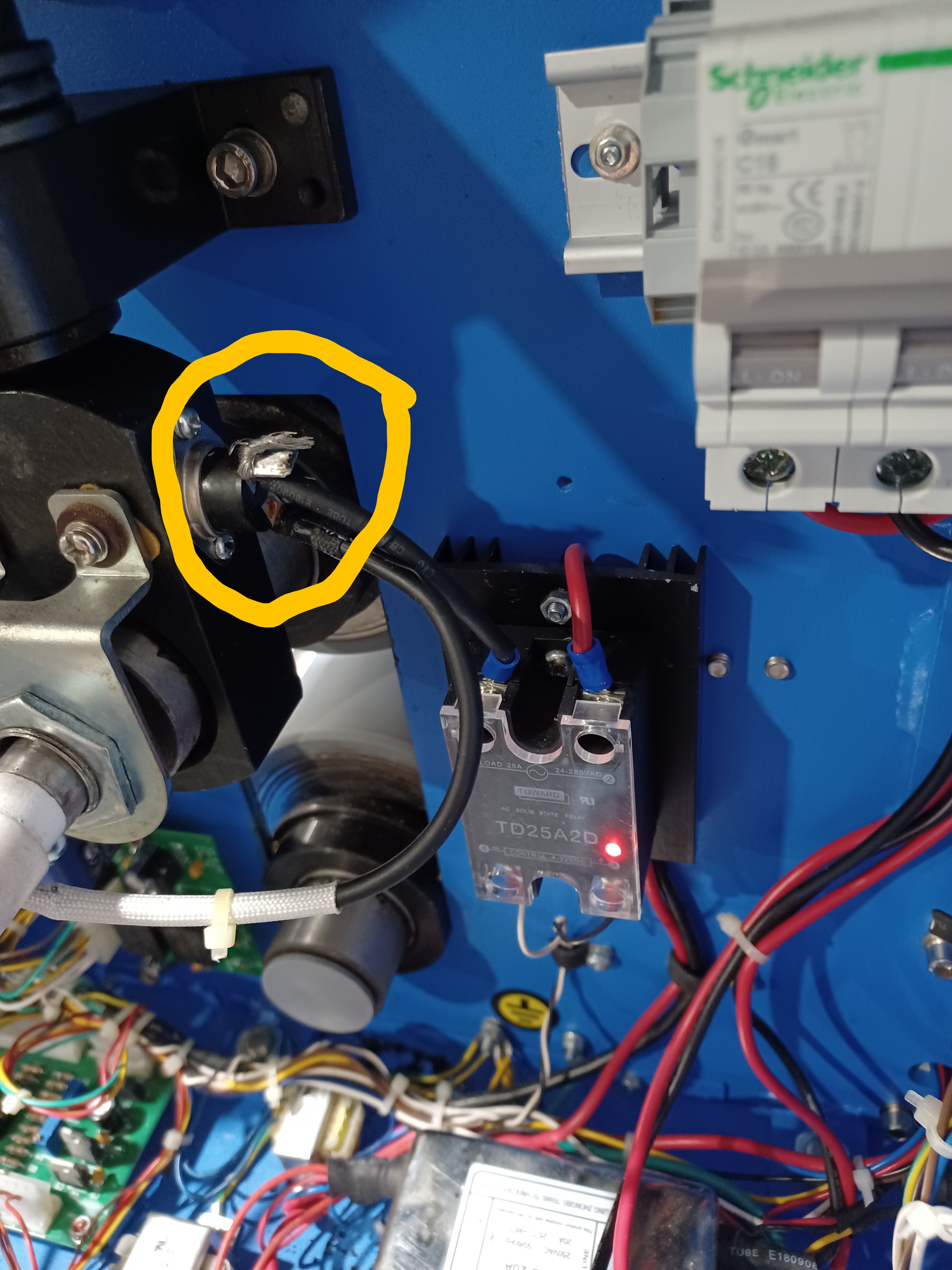

My boss was the one trying to fix the laminator so I'm not sure which part it was, but I attached pictures with the area circled. It was a bad wire. We should of called earlier instead of wasting time switching out parts that weren't bad! Gfp support is great! We have had our laminator for years with no warranty so didn't know what kind of help we would get. My boss got connected right away with a tech who was very nice and helpful and got us back up and running. This is the number we called if you ever need their help. 1-800-986-2005
