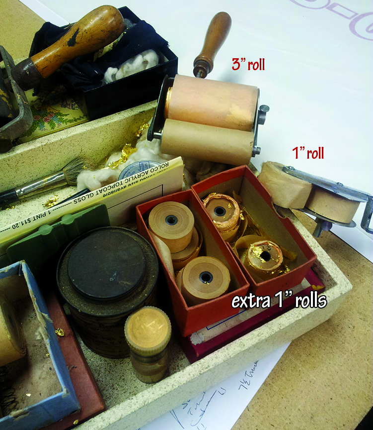

Would you be buying a roll of 1" 23k patent leaf and roll holder from someone like W&B Gold Leaf? get a price for materials and mark it up x5 and see what you come up with
I think you're on the wee side of 23k gilding. I' think closer to $600 or $700 is more like it.
You could save a lotta time if you use roll gold, instead of sheets. Also, have far less waste.

Thanks, everyone! Yes, it has to be the real thing - he is restoring an old safe and trying to be as true to the original as possible. The good news is it will be in my shop as long as I need it.. I was worried about the working time of the size, and if I'd have enough time for the entire face. I like the idea of the roll gold but to purchase 67' when I only need 19' is not something I can justify, but I really like the idea. Not a lot of demand for real gold in my town. Most customers do indeed choose the imitation or the Real Gold vinyl, which I also like. This customer didn't like that idea. Now... the clear coat - I forgot about that, so thank you for the reminder. Let me ask you this, though... the auto body shop that is painting the safe suggested clear coating the whole thing after my leaf is done and a local sign painter paints the detail work. That would be an automotive clear coat, and he suggested to the customer using a matte finish (more in keeping with the dull finish of the black doors). What do you think of that idea? I kind of talked the customer out of it thinking it might dull the glint of the leaf, but perhaps I was wrong?
