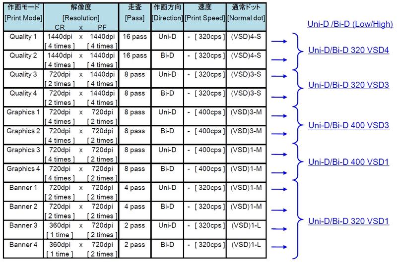

Not sure if this should go here or where but does anyone have a list of all the graphic modes on the mutoh 1324 that shows the specs of each print mode? Or the recommendations.
Umca
Main printmodes...

Most of the stuff i see for the mutoh is 720x1440 i as just curious what the different print setting were as i never knew other than the ones listed in the mutoh recommended print sheet. Guess it was more of a curiosity question lol..
Im just tyring to make it past my grain and color variance issues haha..
