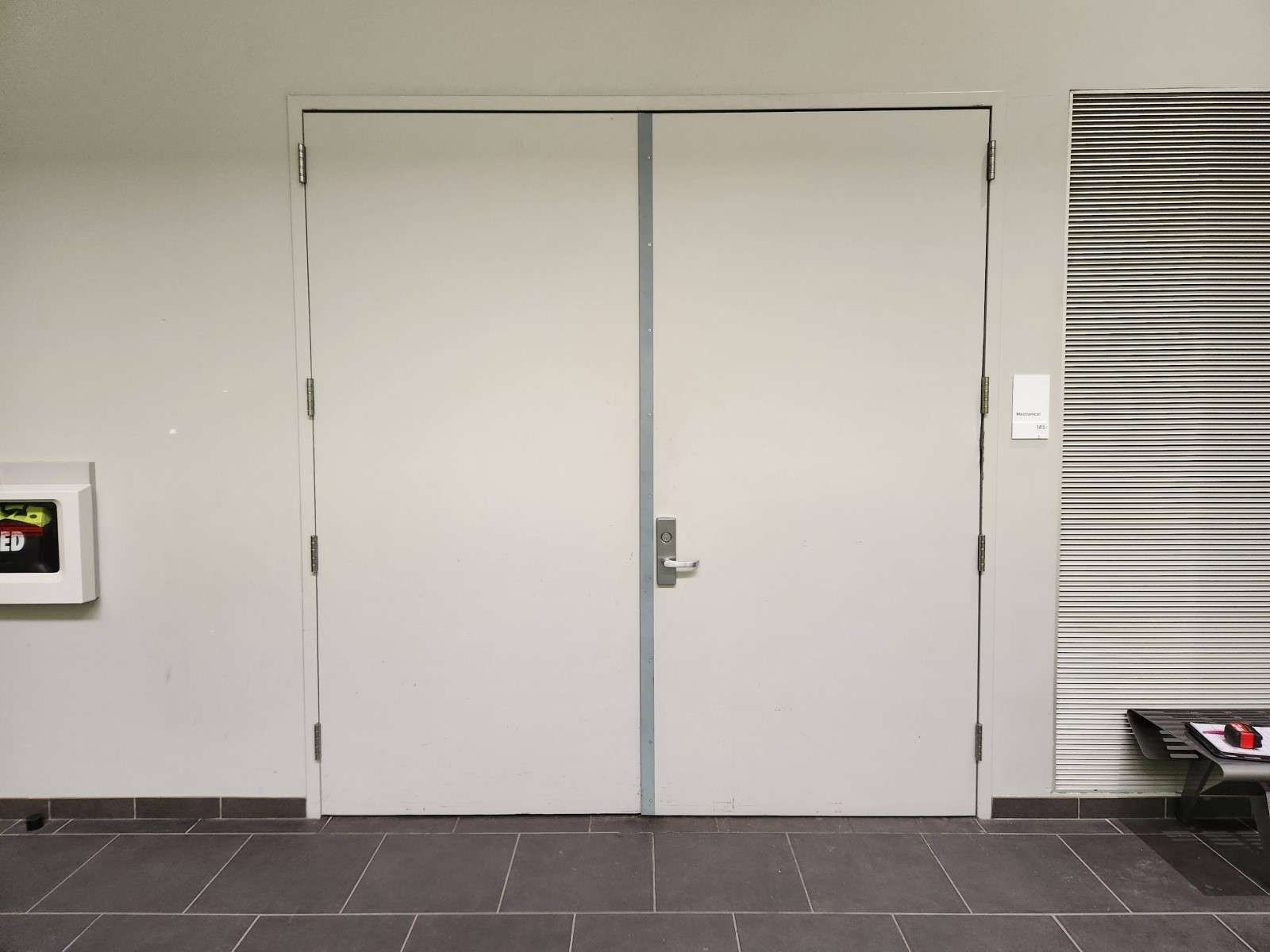

so, I have an upcoming job that involves multiple projects around our campus recreation gym areas (i work for a university). There is a double door that they would like full cover graphics installed on. The door is to a mechanical room, so it stays locked and I didn't get to see the other side of the door knob during our site evaluation. Assuming I print each door as its own panel with a bleed around all 4 sides? Should I just make a slice on the panel and wrap around the knob? We're going to request that they remove the metal plate that covers the gap between the doors. Is there anything else I should be aware of? Anything special about working near hinges? Does it need to be primed first, or not so much, as it's metal and not wood or a wall? First time doing a set of double doors like this, so I'm reaching out to anyone more seasoned, who has any tips or tricks or things to look out for.

You can pull the knob off, stick a paperclip in the little hole and pull it off. Then it's just a little box in the way which shouldn't be a big deal to work around.

thanks - that would be a huge help. can work with the little box, as opposed to this handle situation. Thank you!
