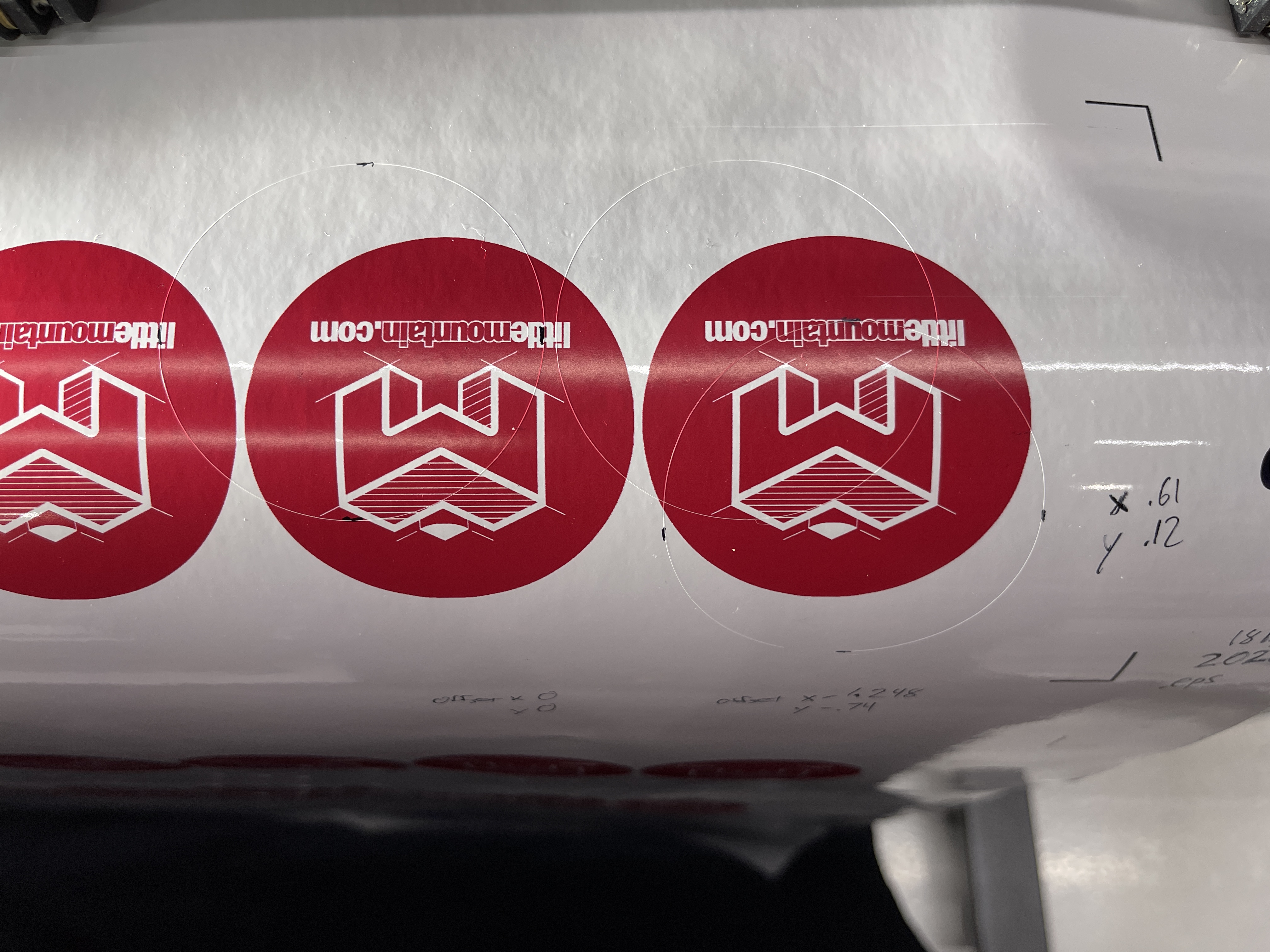

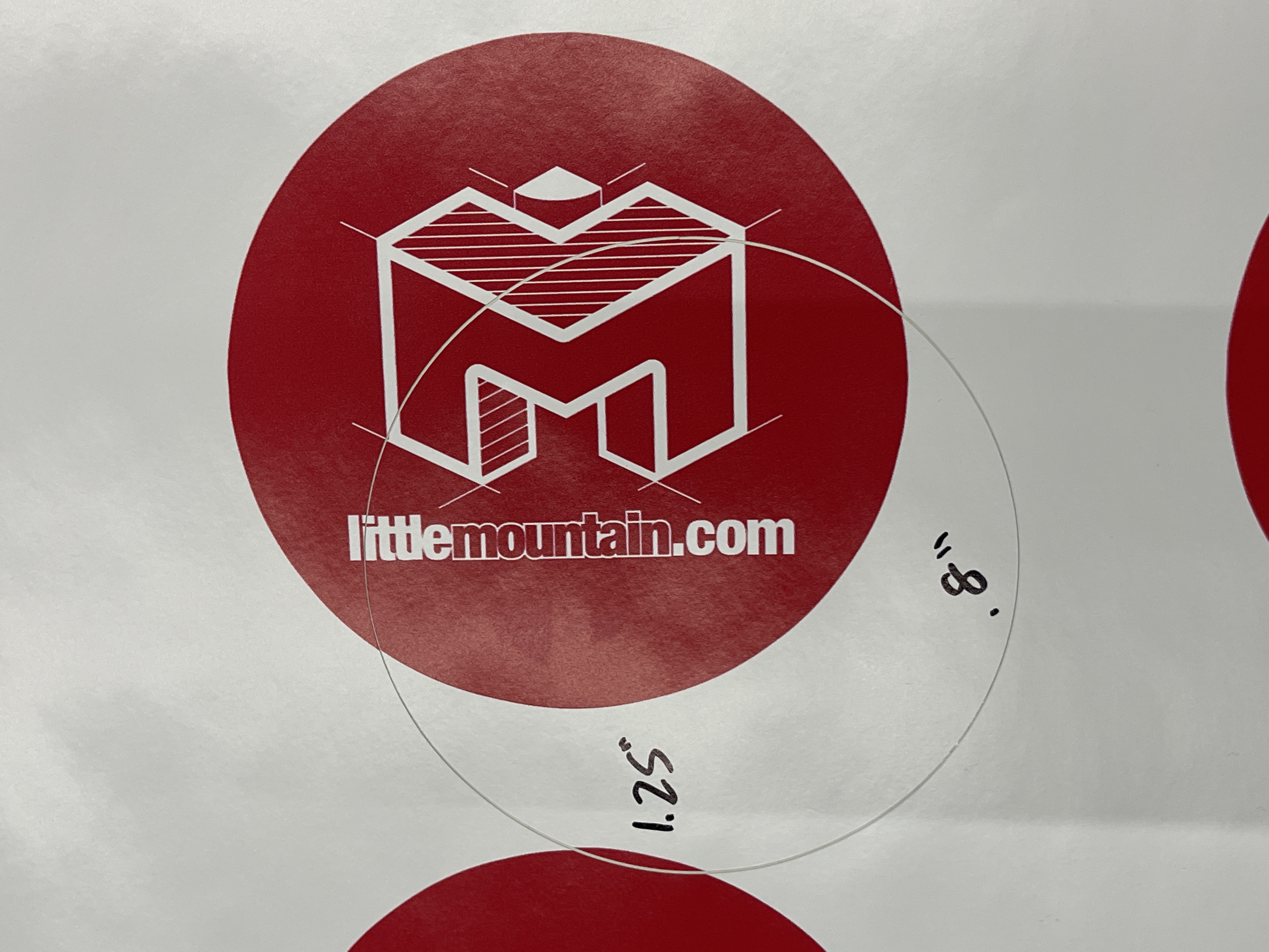

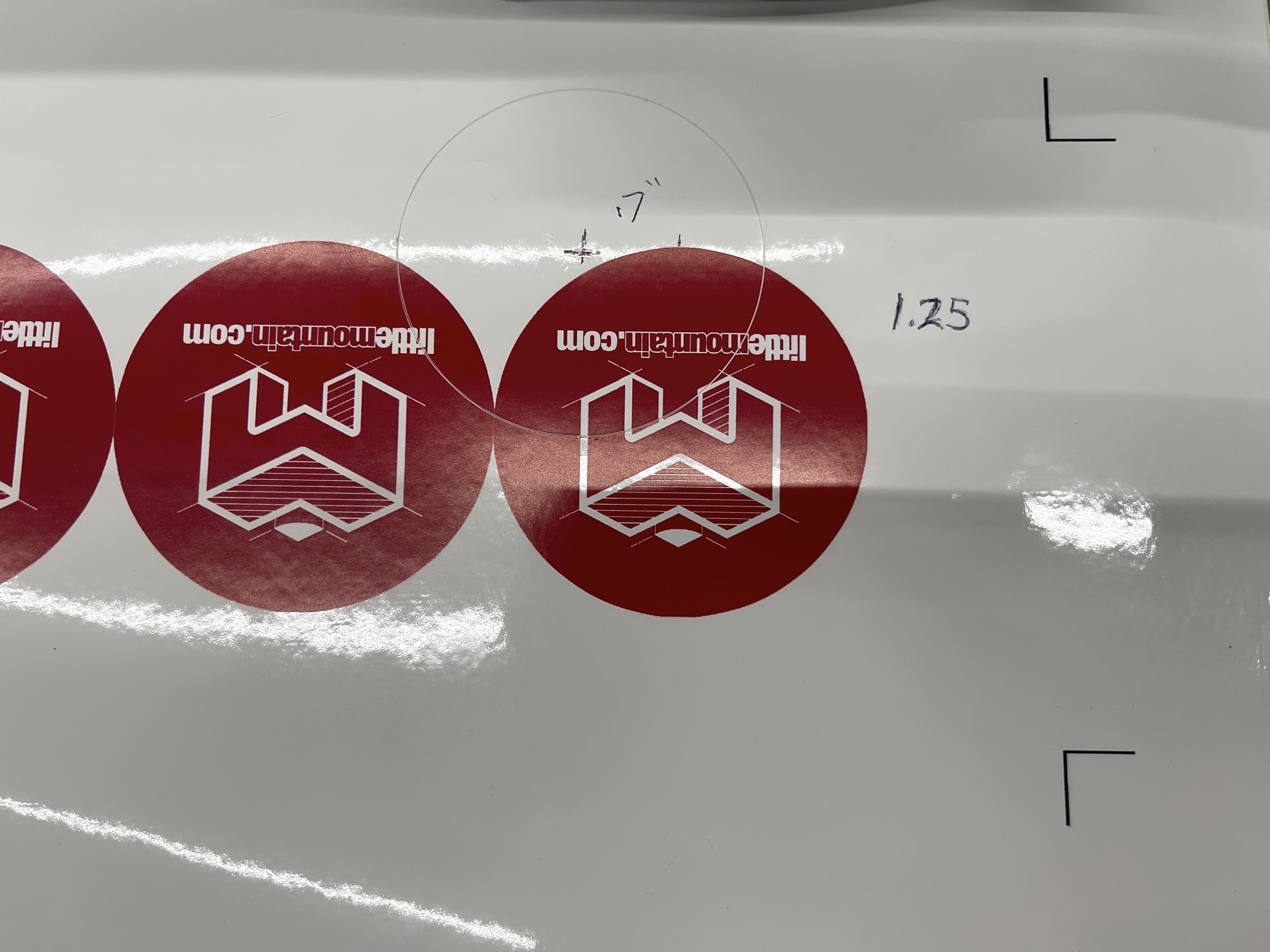

Hey guess what? Yesterday I loaded some laminated reflective vinyl stickers into the graphtec and my cut was a bit off. I discovered that setting the pinch rollers on the tightest setting was actually hindering the movement and throwing my cut off. After I set it to the "lighter tension", it cut as it was suppose to. BTW, I'm using Cutmaster 4 w/ Onyx 19I did several tests with 180º and it was still way off from the marks.

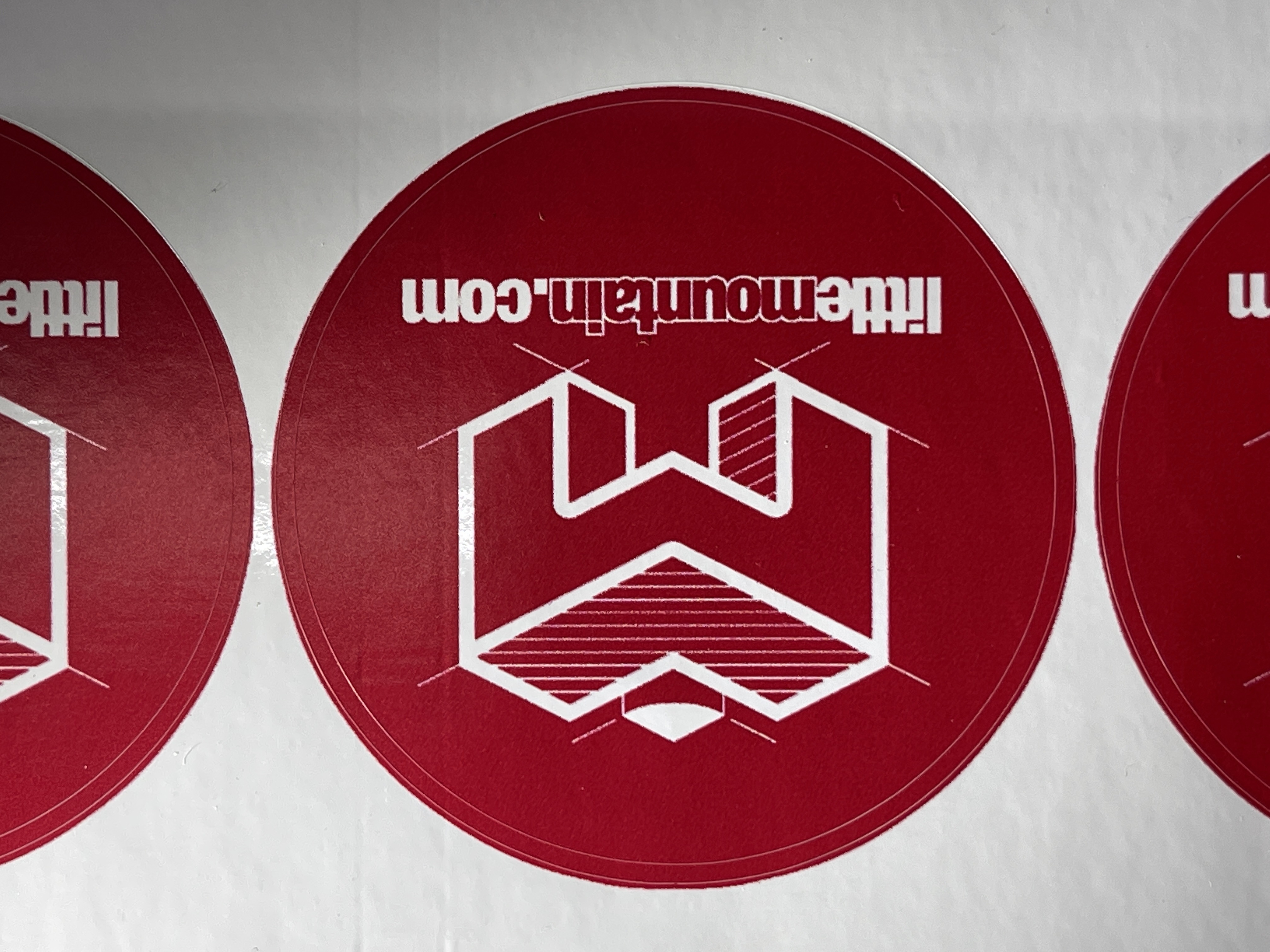

I also double checked the cut line vectors and those are spot on with the kiss cut inside the art and the cut through at the edge of the red.
I also have tried a file of one sticker and multiplied 18 times in Onyx 12 Poster Shop print and cut VS 1 file of 18 stickers printed and cut same issues on both.

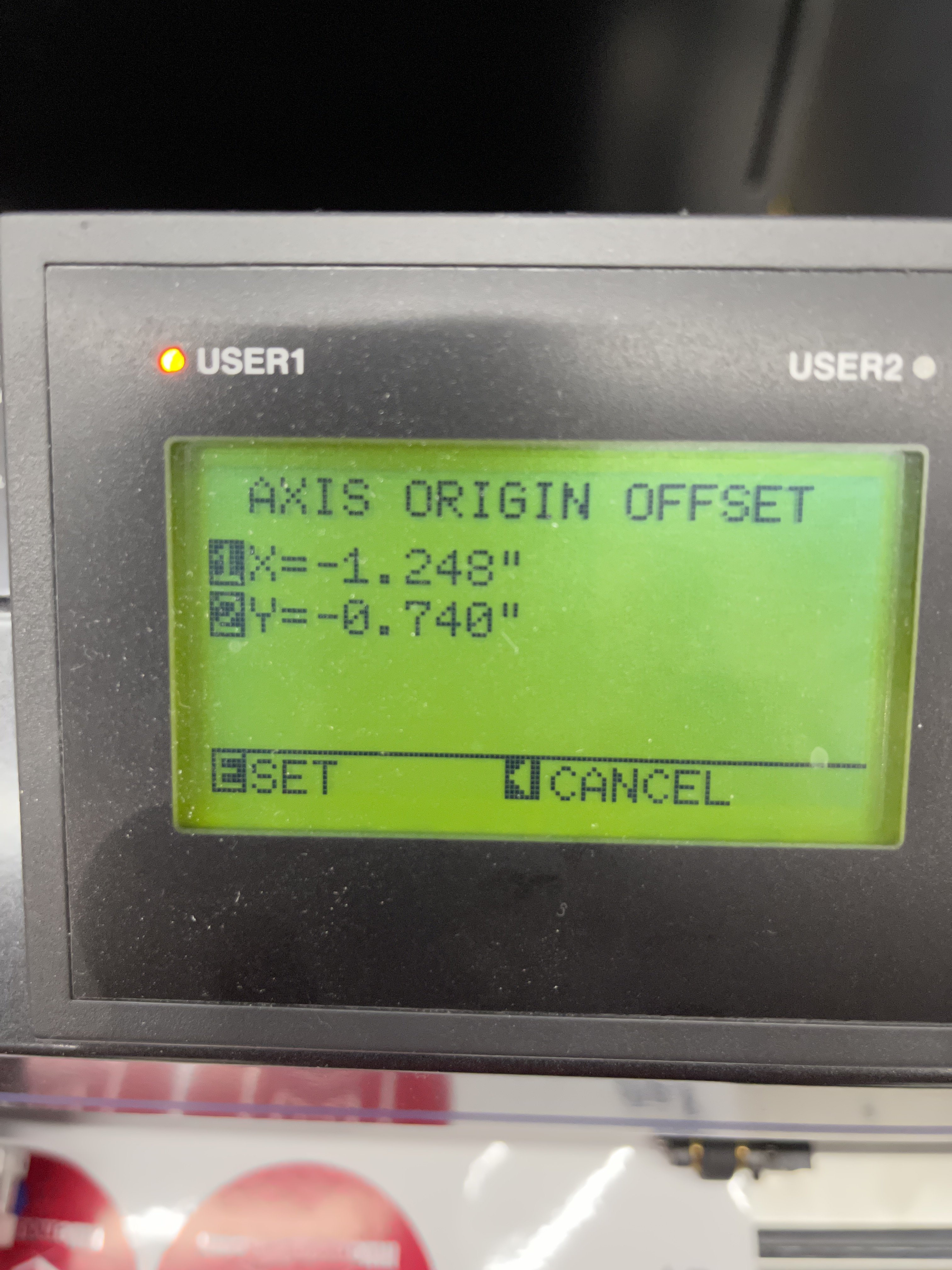

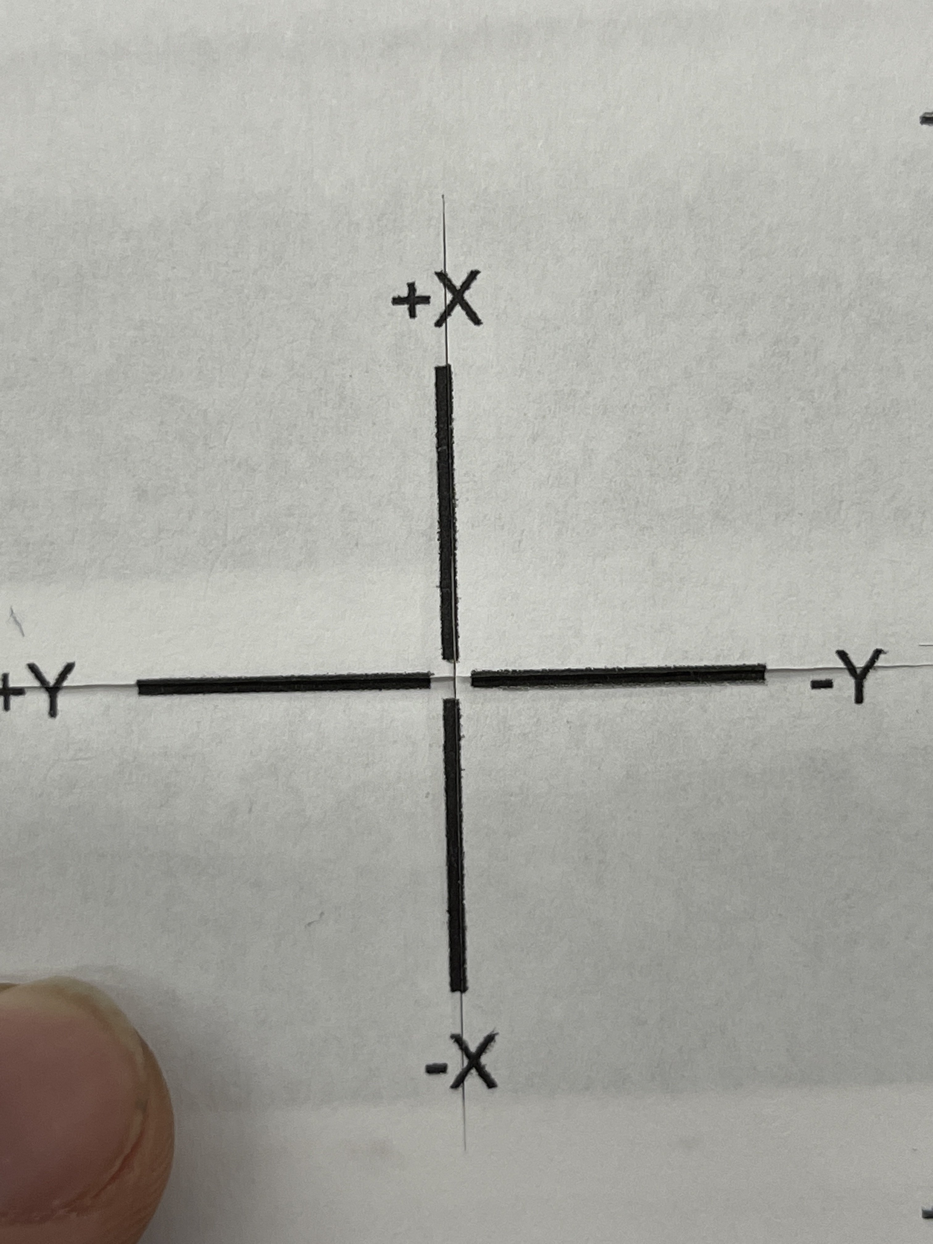

Here is an update from this morning using the axis origin offsets in the graphtec menus.

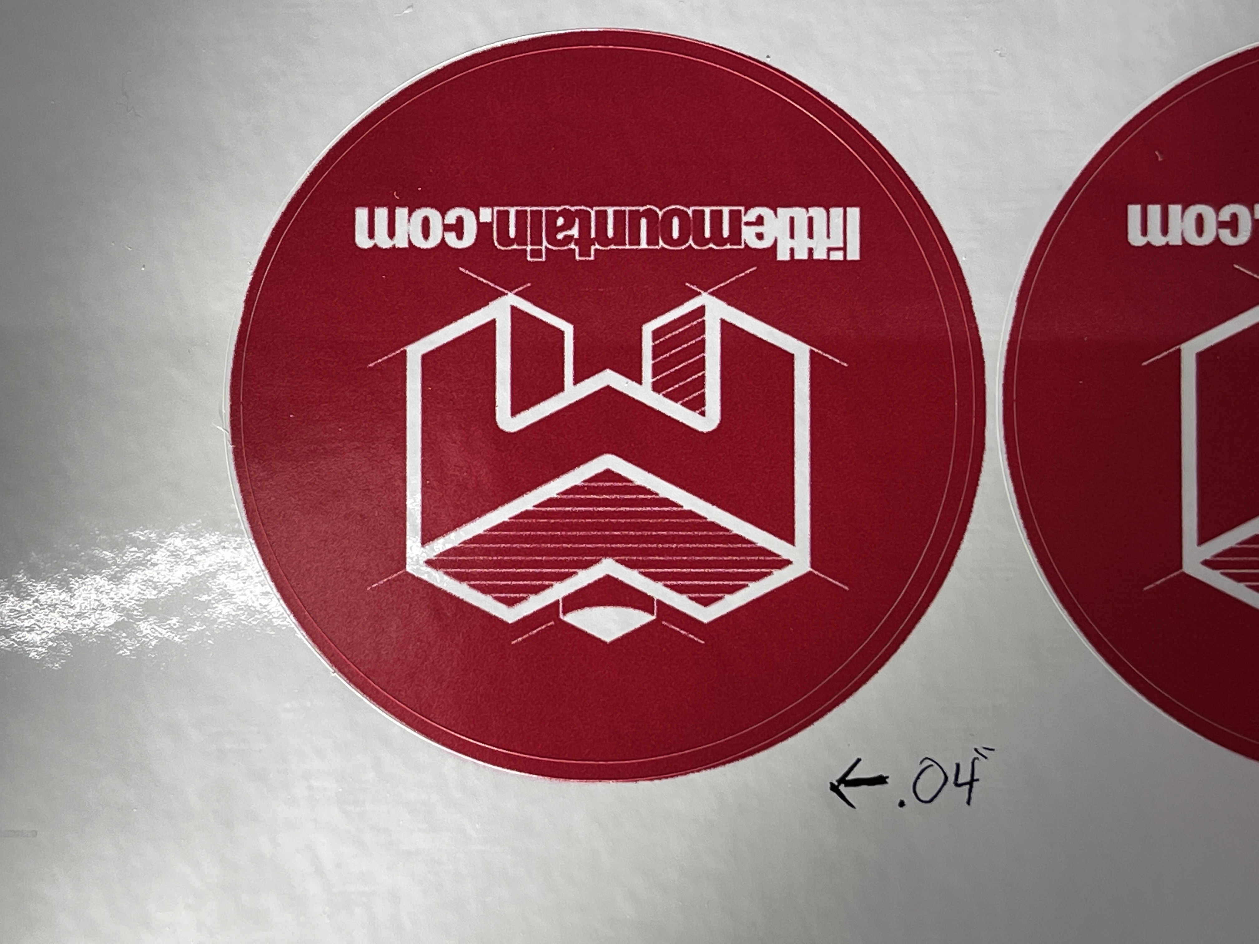

As it cuts the first few stickers on the right of the graphtec it looks pretty good. But as it cuts across the 54" sheet the cut lines get .04" off from center on the left side of the graphtec. The sticker size is 2.7" and 18 stickers across.
