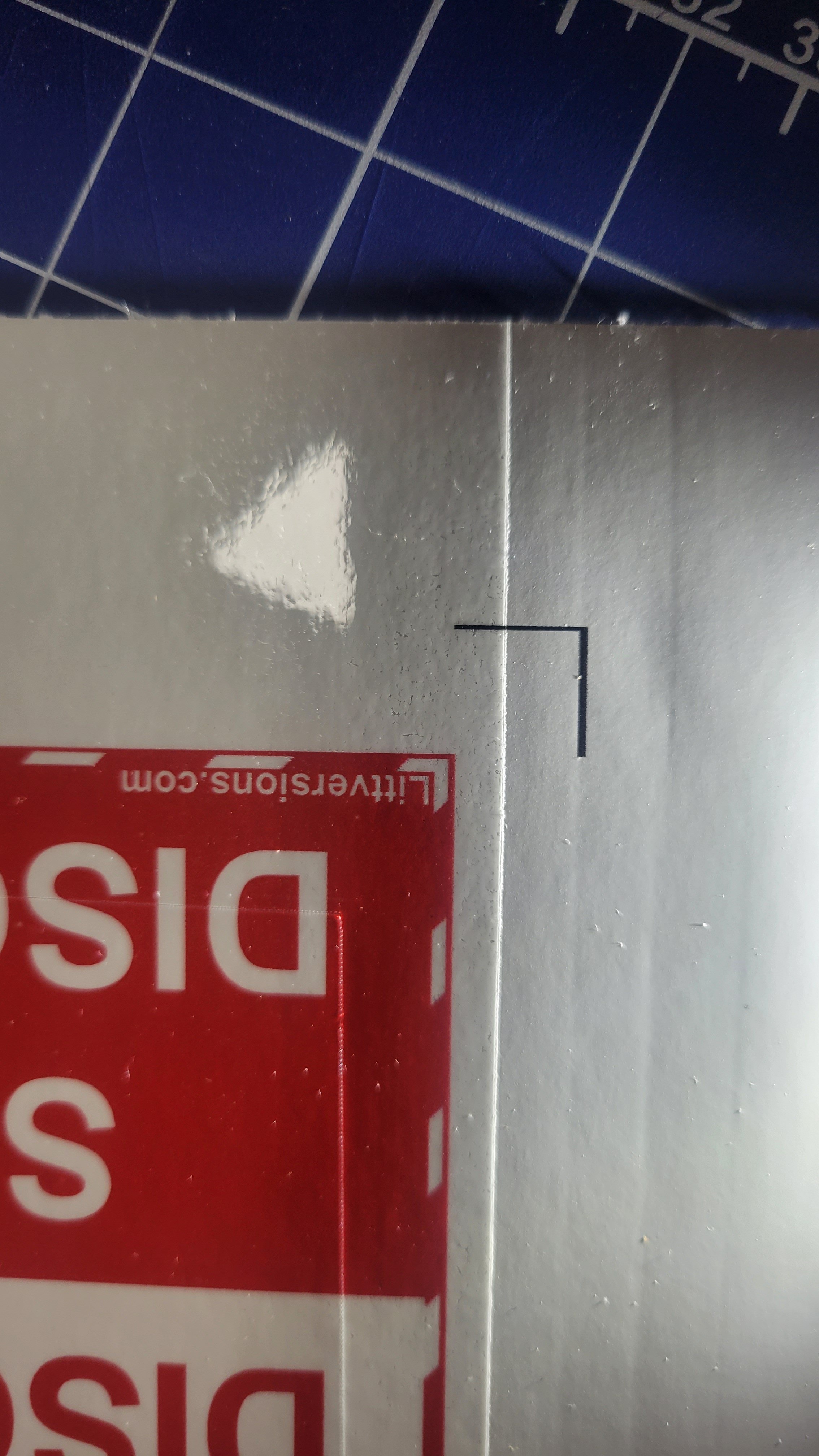

gpslitt
On my fc-8600, if it doesn't read one of the marks and asks to retry, half the time it will start cutting by itself, the other half it will re read and cut properly. I've grown accustumed to just cycle power if it misses and re run it, especially if it messed up on the 10th 8' panel. The 9000 may be totally different though...
There must be some setting to stop cutting if it doesn't detect all four marks like mimaki

Did you watch it happen? Or are you assuming it just read 2 marks and started to cut?
If it doesn't detect all 4 marks... it wont cut. Keep in mind it's an optical sensor, not a Camera.... So it'll try to read a mark, and if something is where the mark should be... it fools itself into thinking thats a mark. So if theres a decal right there... it'll read the decal, think it's the mark and proceed to cut.
I'd put that sheet back into the graphtec...send the same wrong file and watch it. My bet is it reads 1 mark, goes to the second... It'll search within 3-4" of the second mark all around (going back and fourth) until it finds something that resembles a mark, or doesn't find something and throw an error. asking you where it is.
You could turn the scan sensor to be less sensitive... It'll make it only read black marks and doesn't pick up non marks as easy... BUT you're giving yourself way more of a headache as you'll have to manually intervene more often, much easier to not accidently send something twice. Or always use barcodes so the graphtec reads the barcodes and pulls the file without you having to send it.
